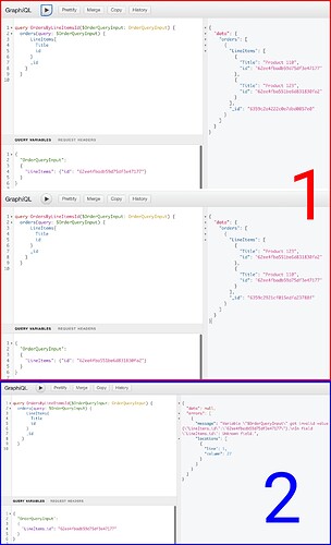

Firstly, I want to show gratitude and thank you for taking the time to help me.
I have forgotten to write that I am using GraphQL to access this data.
I will share screenshots of the GraphQL query and results to make things easier.
(Screenshot RED 1)
You mentioned that my query should show the right results. (and I really wish it did, haha)
Below are screenshots of my query and results when asking for the two products by id. Both return different orders. ("_id" changing)
(Screenshot BLUE 2)
Also below, the results of the query you suggested.
Thank you again,
Zanek

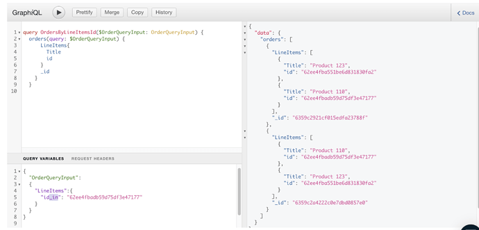

What’s this tho?
I am using next.js(React). Would I benefit from this instead of GQL?
I have got it!!!
Adding “_in” to the query after the id key.
