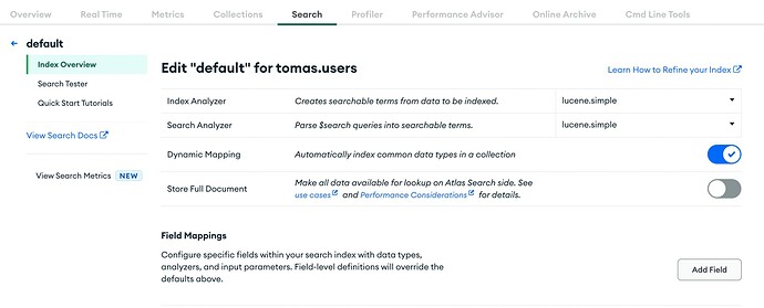

Thanks for quickly response here its my index definition

@tomas_ruffa That analyzer won’t work because the lucene.simple analyzer will strip the @ symbol and the . from the email.
In the visual editor, we do not support the custom analyzer you should build to support this use case.
It would look something like this:
"analyzer": "lucene.simple",
"mappings": {
"dynamic": true,
"fields": {
"email": {
"analyzer": "emailUrlExtractor",
"searchAnalyzer": "emailUrlExtractor",
"type": "string"
"analyzers": [
"charFilters": [],
"name": "emailUrlExtractor",
"tokenFilters": [
"type": "lowercase"
"tokenizer": {
"maxTokenLength": 200,
"type": "uaxUrlEmail"
Thank you so much Marcus I did this and added new refactors to that query by the Atlas UI and now works. Thanks @Elle_Shwer too for the help, both are the solution that I need
