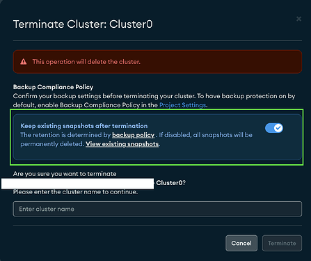

I had a cluster that was created with Keep existing snapshots after termination to On (I could not find the option on the UI, but I did manage to enable it using the option in the atlas terraform provider). After I terminated the cluster, the backup remains as expected, but I could not create the cluster with the same name anymore, and the atlas API on terraform returns the following errors:

Were you able to see this from the UI when trying terminating a cluster?

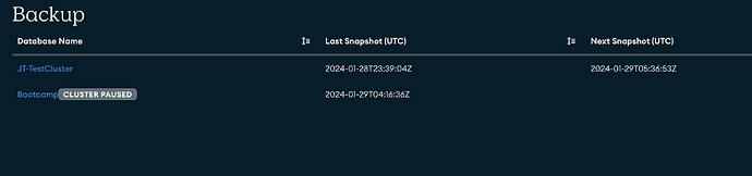

Checked that the backups still existed (from the Backup section). They still were there.
Terminated all backups associated with the cluster created from step 1.
Checked the Backup tab to see if it was still there. It was (Cluster0 for reference):
I will try find out how long this generally takes but for me, it seems to have taken only a few minutes on my own test Atlas project (assuming all backups associated with the cluster in question were terminated).
In terms of “Backup entry”, I believe you are referring to the cluster name which shows up in the Backup tab under the Security section of the Atlas UI (On the left hand side). If so, then yes based off my testing, after removing the snapshots within that “Backup entry” (i.e. the terminated cluster name) and waiting a few minutes the entry itself will be removed so that you can create your new cluster with that name.
