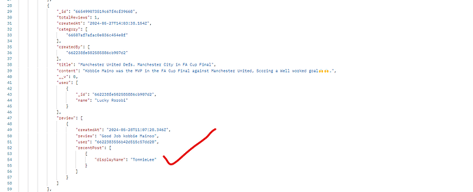

Please below is a screenshot of the output when i run on postman, the area i circled in red, i would like to know how i can get the detail of the user that made the review, i dont know what to do next in the code that wont slow down the performance of the Application
After doing some thinking, i was able to get the desired result, i discovered i didnt need to add the $unwind function, i only needed to add another $lookup function in the review pipeline to get what i was looking for, below is the code along with the screenshot from Postman.
