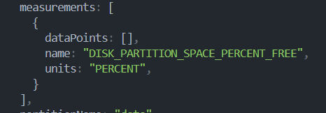

No matter what I do, there is no data here
This might only be available for dedicated tier clusters (M10+) what cluster type do you have ?
I am currently on M2 tier.

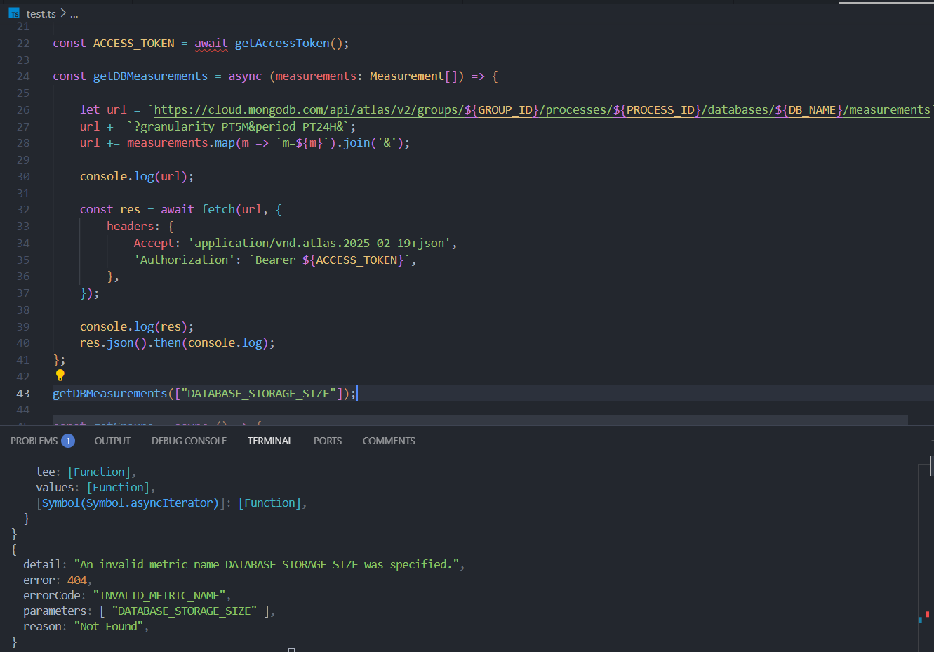

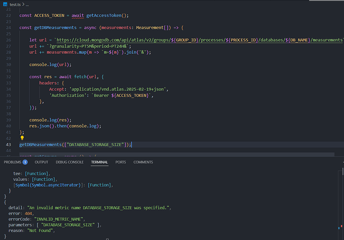

You may be able to check the space a given database is taking up (DATABASE_STORAGE_SIZE), with the getDatabaseMeasurements instead.

Sorry, I missed that. Anyways, I had already tried that before your comment after I found that route while looking through the API docs and failed. For this route, nothing is working at all!
Basically any none of the metrics mentioned in this route is not working. Everything returns INVALID_METRIC_NAME
