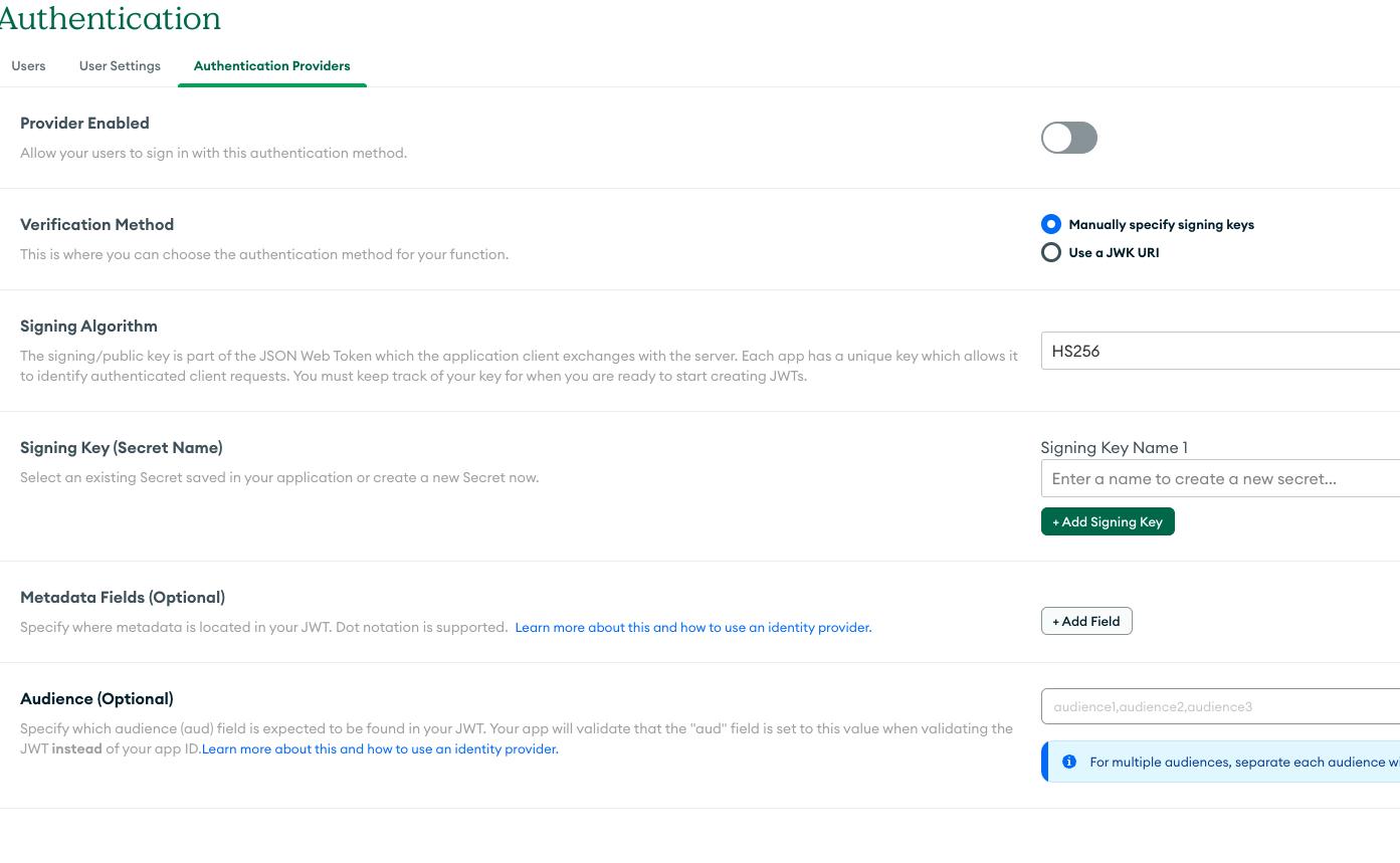

Im trying to connect my existing backend JWT (Laravel Sanctum) to a new Atlas Sync app.
My app works entirely with the JWT right now but i am trying to use the Custom JWT from atlas. Im not sure how to connect it.
In the settings I do not see a way to specify my server URL or the JWT generation URI.
In the docs you can see the user passes the credentials to the Realm App, in my case this s phone number and a one time code. Then realm Forwards credentials… but since i cant set up the URL how do i know where realm is sending these credentials ?
What am I missing here?

Hi Luis, it may be too late for you at this point but I am answering this for everyone else as a former TSE I used to build custom JWTs for customers and troubleshooted them.
You don’t need to specify your server URL or JWT generation URI in Atlas App Services. Instead, focus on configuring the Custom JWT authentication in Atlas to validate the JWTs issued by your Laravel Sanctum backend. The Realm SDK handles the transmission of the JWT to Atlas, where it is validated based on the settings you’ve configured.
Unless MongoDB training for TSEs have failed me, this is how it worked for the couple of years I worked for MongoDB:
JWT Issuance on Your Backend: When a user logs in to your app (using phone number and one-time code), backend issues a JWT.
Passing JWT to Atlas: Your client app (i.e. mobile or web) then takes this JWT and passes it to Atlas App Services via the Realm SDK.
JWT Validation: Atlas App Services validates the JWT. You don’t need to specify your server URL or JWT generation URI in Atlas. Instead, you configure Atlas to either manually validate the JWT using a signing key, or validate it using a JWKS if provided by the third-party system.
Now, be sure to:
Enable Custom JWT Authentication
In the App Services UI, go to Authentication > Custom JWT Authentication and enable it.
Manually Specify Signing Keys
Set it to HS256 like shown in your photo.
Add the signing key generated by sanctum.

Let Atlas use the JWT to authenticate the user based on the manually signed keys.
When your users log in using the Realm SDK and provide the JWT, Atlas App Services directly validates the JWT against the signed keys.
There’s no need to worry about Atlas forwarding the credentials somewhere else; it’s all handled internally based on the JWT’s content and signature verification.

Step 2: Configure MongoDB Atlas to Accept JWTs
- Enable Custom JWT Authentication in Atlas: Go to the Atlas App Services dashboard, and navigate to the Authentication section. Enable Custom JWT Authentication.
- Configure JWT Validation Settings:
- Verification Method: Use the
JWKS URIprovided by your Laravel application or JWT provider. - Signing Algorithm: Select
HS256or another algorithm supported by Laravel Sanctum. - JWKS URI: Provide the endpoint for the public keys that Atlas can use to validate the JWTs.
- Set Up Metadata (Optional): Configure metadata fields within the JWT that Atlas should use for additional validation or data extraction. For instance, the JWT payload might include claims like
sub(subject, typically the user ID),exp(expiration time), and custom claims likerolesorpermissions.
