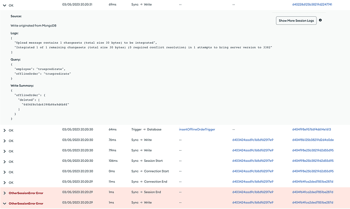

Thank you for your response. The request id for the error log is 6404eaa54c509266ce223b8f. It looks like it was deleted because we are not able to find the associated document _id in the database.
Hi, if you look at this link (it is safe to post, noone else can view other than you and MongoDB employees) you can see the error happen, the client reconnect, and upload the proper document (can see the _id in the write summary section of the log): App Services
In fact, if you follow it through, we can see why this document doesnt exist: (link was hard to show the exact events)
Here is a more complete timeline: App Services
It looks like someone deleted the document in MongoDB. My hunch is that the trigger you have setup did it, but I can’t be certain without looking in more detail.
Let me know if this sounds right to you, but it sounds like the error has nothing to do with the document disappearing as that is just a coincidence of someone/something deleting the document in MongoDB at roughly the same time.

Yes, you are correct. The document write was attempted again and was successful. We are deleting it in the trigger and rewriting into another collection. Thank you for your support.
