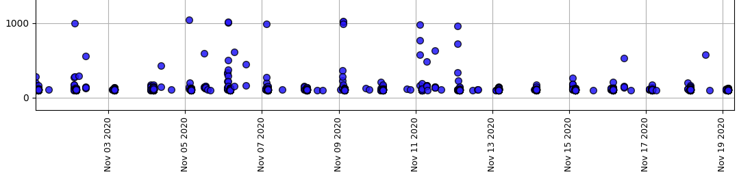

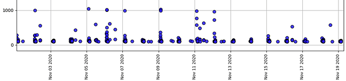

mlogfilter ‘mongod.log’ --word exception --namespace <db.colloection> | mplotqueries`
:arrow_right: filter all log lines with the string “exception” and visualize
The dots can be clicked and will show the actual log line.
