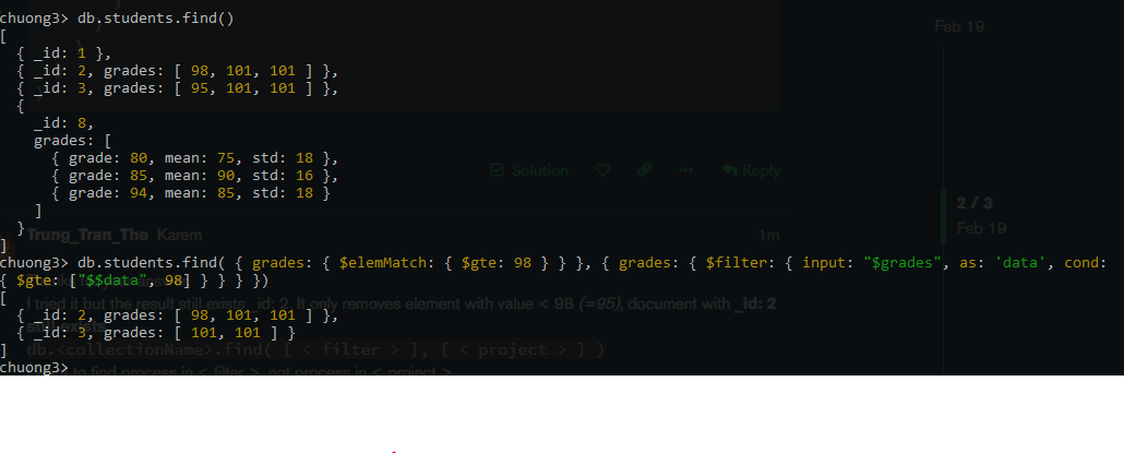

I want to filter documents with elements in the array that must satisfy the condition (using find()). I tried many ways, including $elemMatch, but still not correct.

Thanks for your answer,
I tried it but the result still exists _id: 2. It only removes element with value < 98 (=95), document with _id: 2 still exists.
db.<collectionName>.find( { < filter > }, { < project > } )
I want to find process in < filter >, not process in < project >
My code:
db.students.find(
  { grades: { $elemMatch: { $gte: 98 } } },
  { grades: {
     $filter: {
        input: "$grades",
        as: 'data',
        cond: { $gte: ["$$data", 98] }
What are you expecting? can you show the expected result, In your first post’s screenshot, you have strikeout the 95 in _id: 3, so I thought you want values that are greater than or equal to 98.
Do you mean all the elements in grades should be greater than or equal to 98? then try $all operator inside $elemMatch to check for all elements,
db.students.find({
  grades: {
    $elemMatch: {
      $all: [98]
I tried it but the result still exists _id: 2. It only removes element with value < 98 (=95) , document with _id: 2 still exists .
Sorry bro, I mean _id: 3.
If all elements are >= 98 then the current document will be retrieved. Otherwise, no
