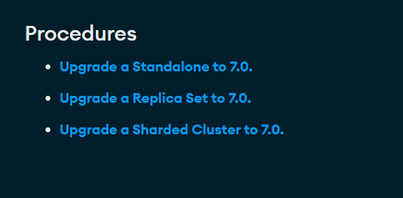

I event can’t understand what instruction should use
Is it replica set?

REF: https://www.mongodb.com/docs/manual/release-notes/7.0-upgrade/
The second is the replica set.
