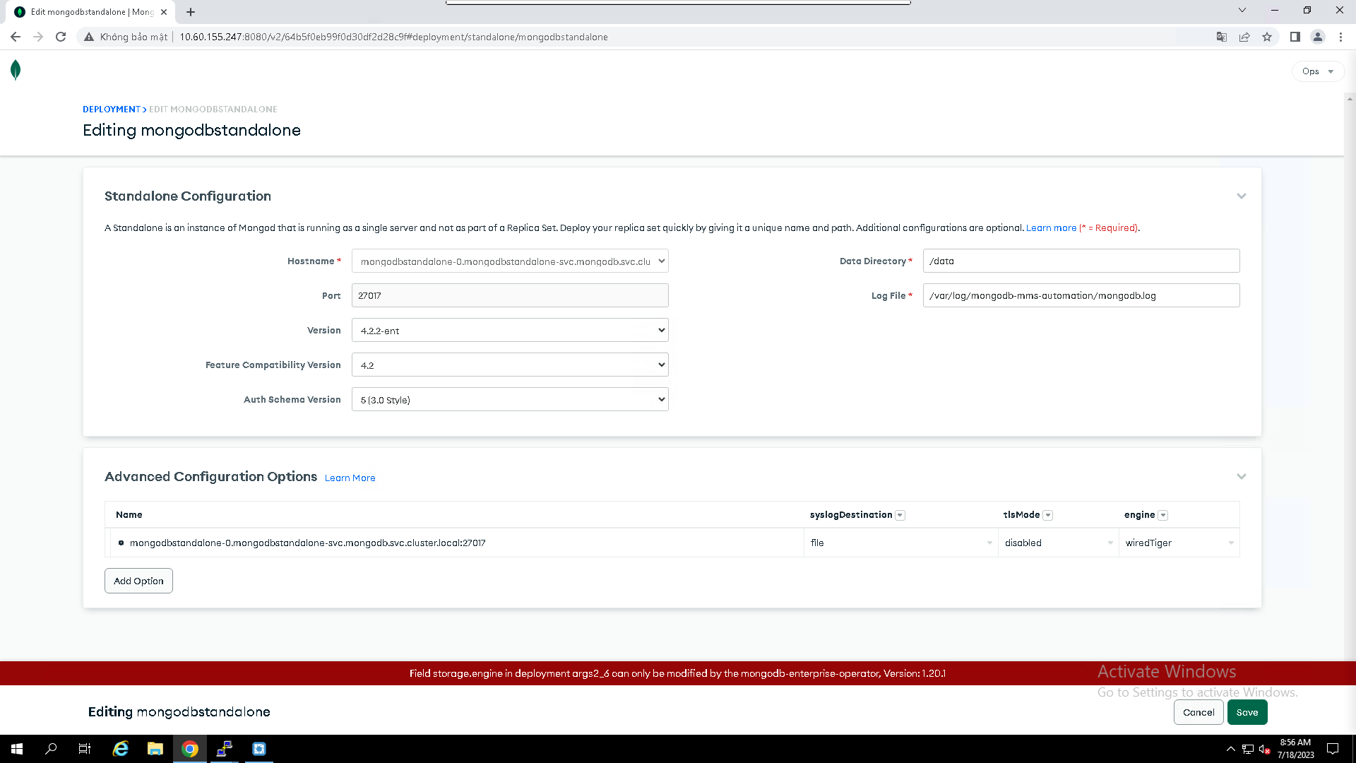

Hi @chris
When i update storage engine in ops manager, I got this error: “Field storage.engine in deployment args2_6 can only be modified by the mongodb-enterprise-operator, Version: 1.20.1”.
So i’am using kubectl edit mdb to change storage engine:

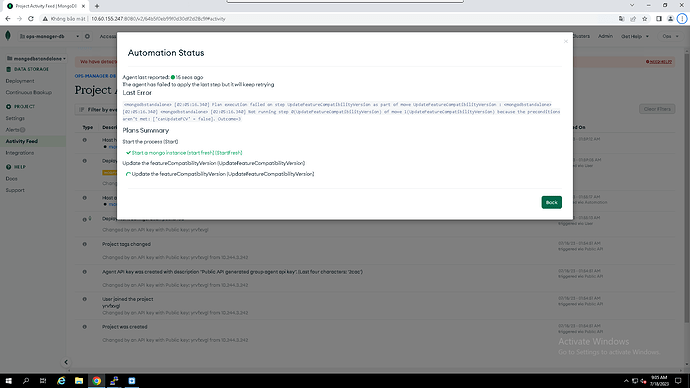

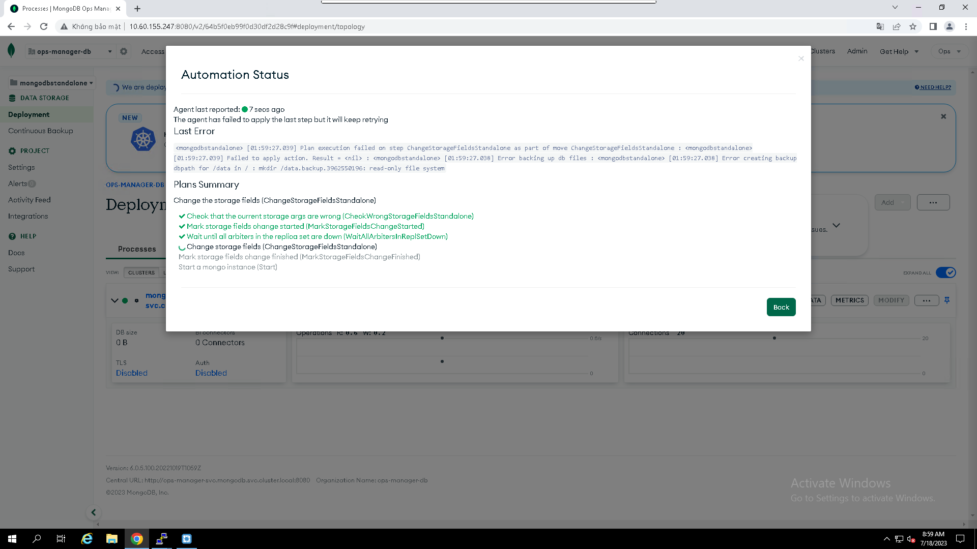

Unfortunately, i am facing this error:
Please tell me where I’m wrong.

One of the errors is due to the permissions. It seems you may have selected /data as the dbpath rather than a directory under it.
The second error could have a few causes and full output from the agent would be needed to diagnose more.
I would suggest you open a support ticket with MongoDB for them to assist you further.
