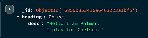

Additionally, this depends on how you’re storing the string in the database. E.g If you use the MongoDB .NET/C# driver to insert a string like this (E.g “Hello I am Palmer. \n I play for Chelsea.”), the \n is interpreted by C# as a newline character and the string stored in MongoDB will be with the actual line break (without the characters \n).
So when you retrieve it and try to print it via Console.WriteLine(), it would display exactly as you expect above.
Hello I am Palmer.
I play for Chelsea.
For your application, this isn’t the case I presume and the string is being stored/imported separately in your collection it seems :slight_smile: Hope that helps.
