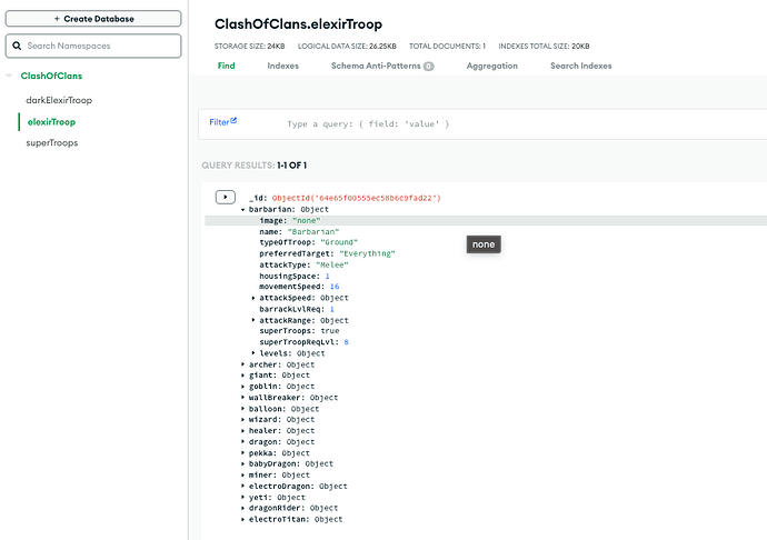

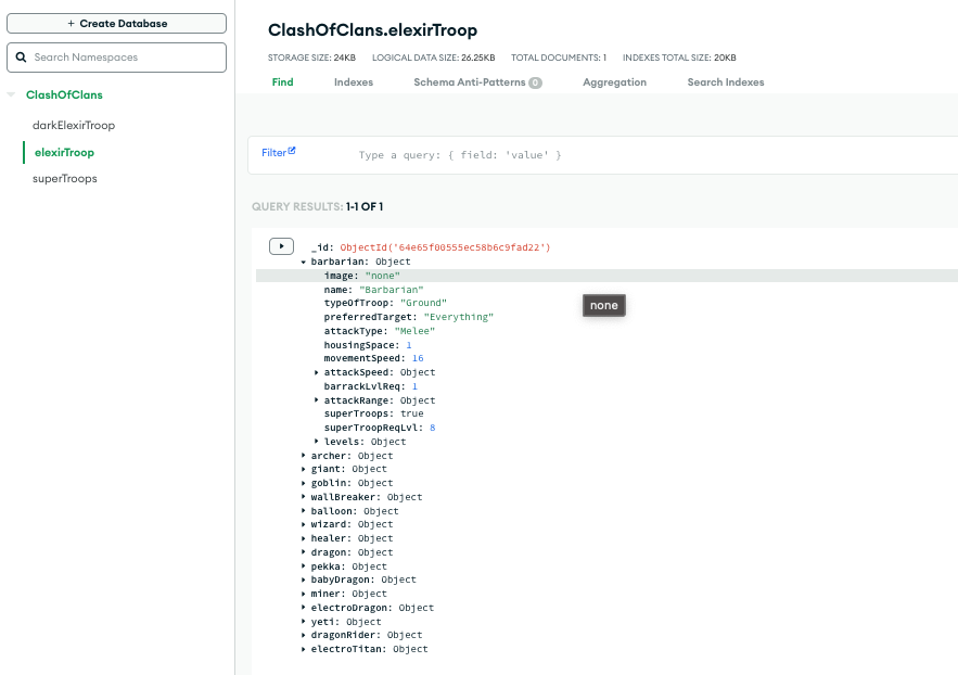

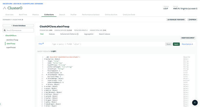

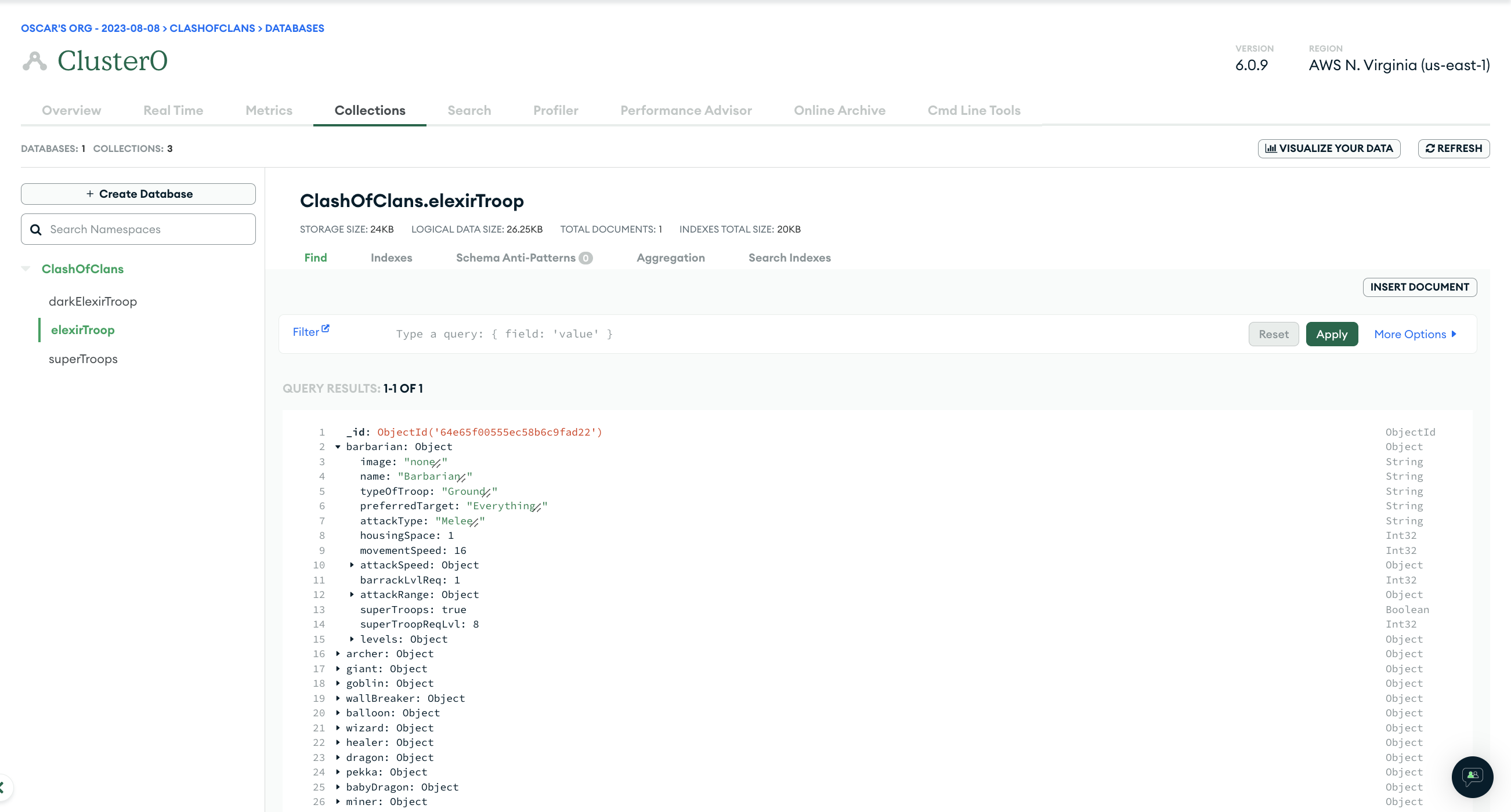

MongoDB
ClashOfClans (database)
darkelexirTroop (collection)
superTroops (collection)

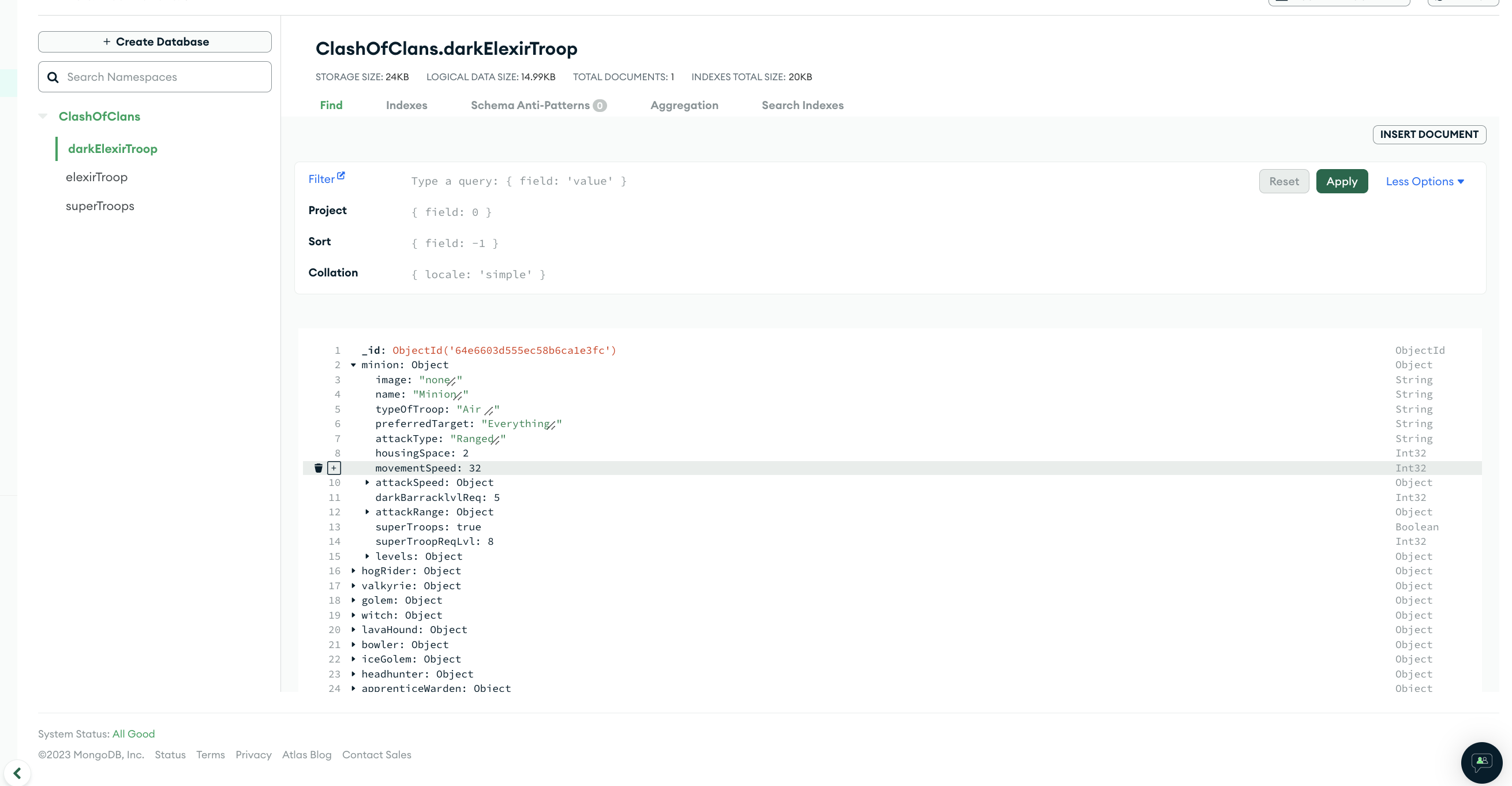

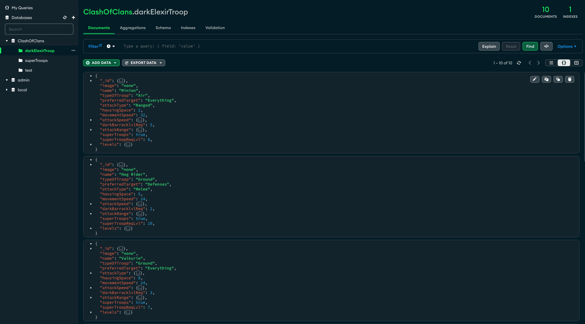

Inside darkElexirTroop
minion:
image:"none"
preferredTarget: "Everything"
attackType: "Ranged"
housingSpace: 2
movementSpeed: 32
attackSpeed:
value: 1
unit: "s"
darkBarracklvlReq: 5
attackRange:
range: 2.75
value: "tiles"
superTroop: true
superTroopReqLvl: 8
levels: (contain a document per level with info like above)
levelOne:
levelTwo
//it keeps going
img is attached.
