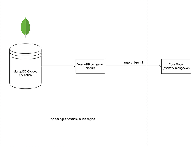

So, just to make sure I understand correctly, is this an accurate representation of your situation? You can make changes only in your code, and only want to use bsoncxx/mongocxx?
Note: I am assuming here that your code can’t directly connect to MongoDB collection. If you can, then you can directly fetch the BSON documents using the C++ driver into a bsoncxx document.
Wow. Yes this is accurate enough, the specifics are that my module IS a consumer but has to adhere to a standard defined somewhere upstream and used by all other consumers (bson_t in a predefined structure).
Is your code making direct connection to the MongoDB collection?
Who is responsible for fetching the BSON docs from MongoDB collection and populating it with bson_t?
