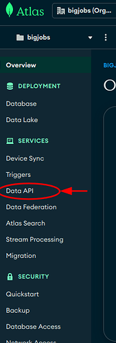

It looks like you are trying to use the Data Api to insert data however hostname string is the form of a connection URI that would be used with a client driver.
If you wan to use the Data API set up the Data Api on your Atlas project.

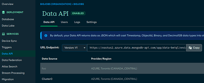

If you are using the Data Api there will be an https endpoint created. As per this screenshot:
If the URI starts with mongodb:// or mongodb+srv:// is for use with the mongodb client drivers. If you want to use the Data Api the end point will need to be created and the provided URL will be what is needed in the code.
