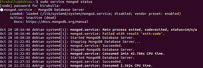

On my new server I have restored to the port 27018 as per my previous commands when I type mongo and run show dbs I can see the restored db however when I check sudo service mongod status its showing inactive

Here is what I get when I do sudo service mongod status and I have updated port to 27018 in config file

If I understood it correctly I have ran the ssh tunnel on new server which makes all the request forwarded through port 27018 to old server (the db from which Im going to dump) with default port.
when I do mongo on new server this is what I get -

However when I do mongo --port 27018 on the same new server this is what I get-
mongo --port 27018
MongoDB shell version v4.4.17
connecting to: mongodb://127.0.0.1:27018/?compressors=disabled&gssapiServiceName=mongodb
