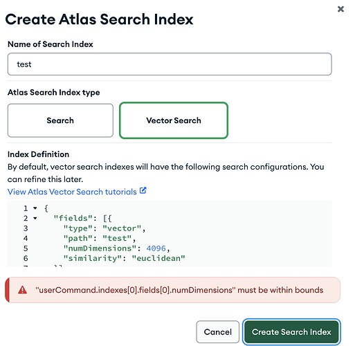

If I use MongoDB Compass I get the same error message:
From the documentation it looks like it should support up to 4096 dimensions. How can I make this work?
