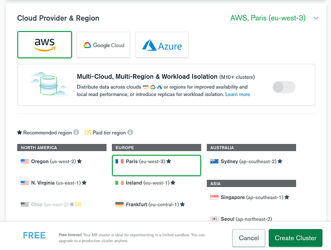

From what I see, Paris is available for the Free Tier and I think you don’t need to setup a credit card for the Free Tier. It’s not recommend for a prod environment but for a small project like this and for a development environment, it’s more than enough I think.
