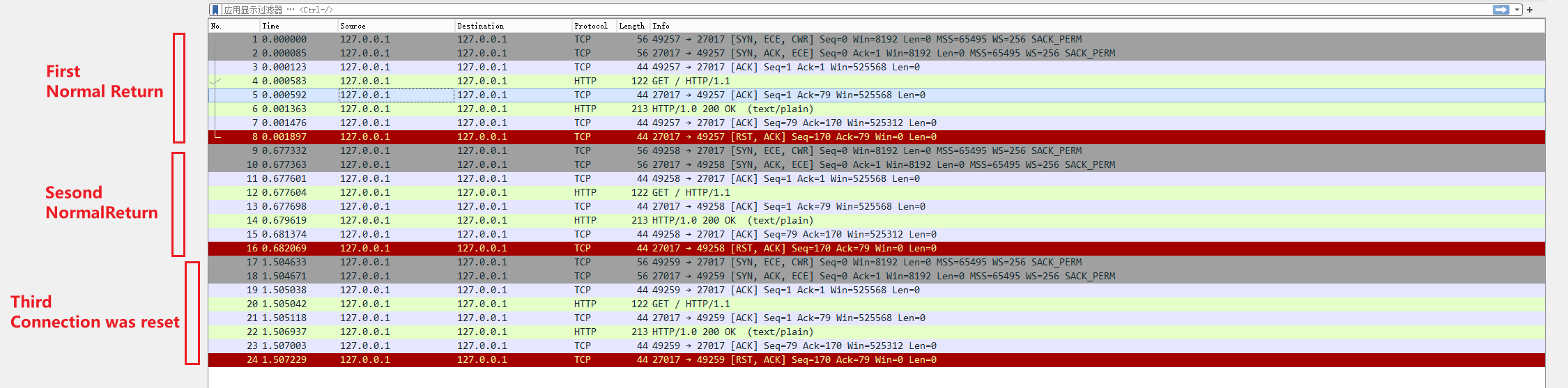

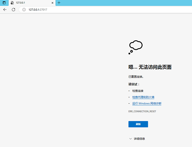

I have installed mongodb on my local machine, and when I access port 27017 through my browser after the startup is completed, I may have the problem that the connection is reset when I refresh the page frequently, please help me to see what causes it.
Here is my usage information:
OS: Windows Server 2012 R2 Standard
Memory: 8G
MongoDB Version: 4.2.17
Conf:
dbpath=../data
logpath=../log/mongo.log
port=27017
maxConns=5000
bind_ip=0.0.0.0
auth=true
wiredTigerCacheSizeGB=4
Launch Script:
@echo off
@echo mongodb started……
title mongo-4.2.17
cd bin
mongod -f ../conf/mongo.conf
pause

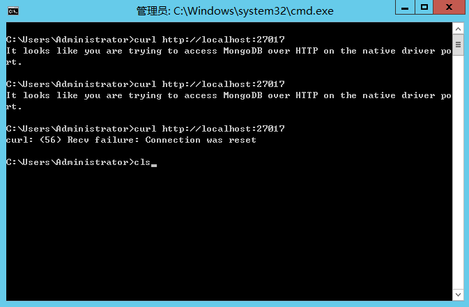

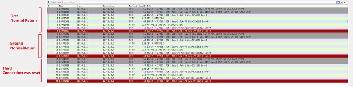

This is the log of 10 visits to the http://127.0.0.1:27017 page after I started mongodb (6 normal responses and 4 connection reset errors).
