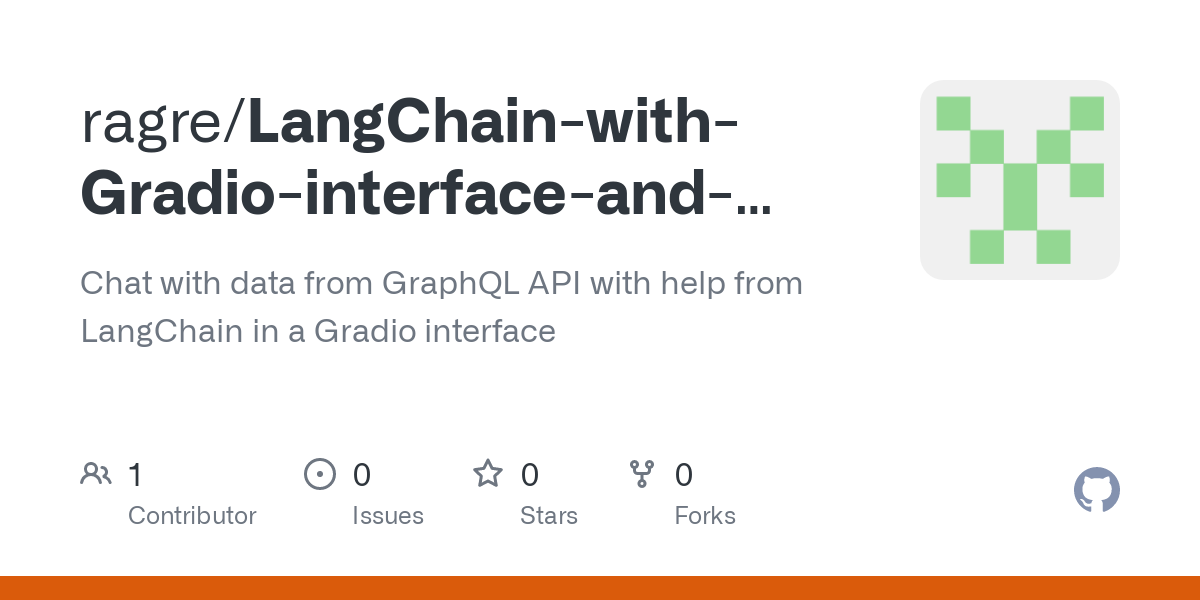

Yep, exactly. I have made a small demo using LangChain, ChatGPT and GraphQL API (not MDB). The verbose in the output shows the generated GQL query:

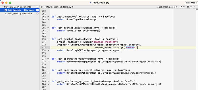

Found a solution to connect to MongoDB with GraphQL API auth.
  1. Download the LangChain package: GitHub - langchain-ai/langchain: ⚡ Building applications with LLMs through composability ⚡
  2. Edit the load_tools.py file so it can take a “headers” input (apiKey: “xzy”)
  3. pip install the package in your Python script/terminal
