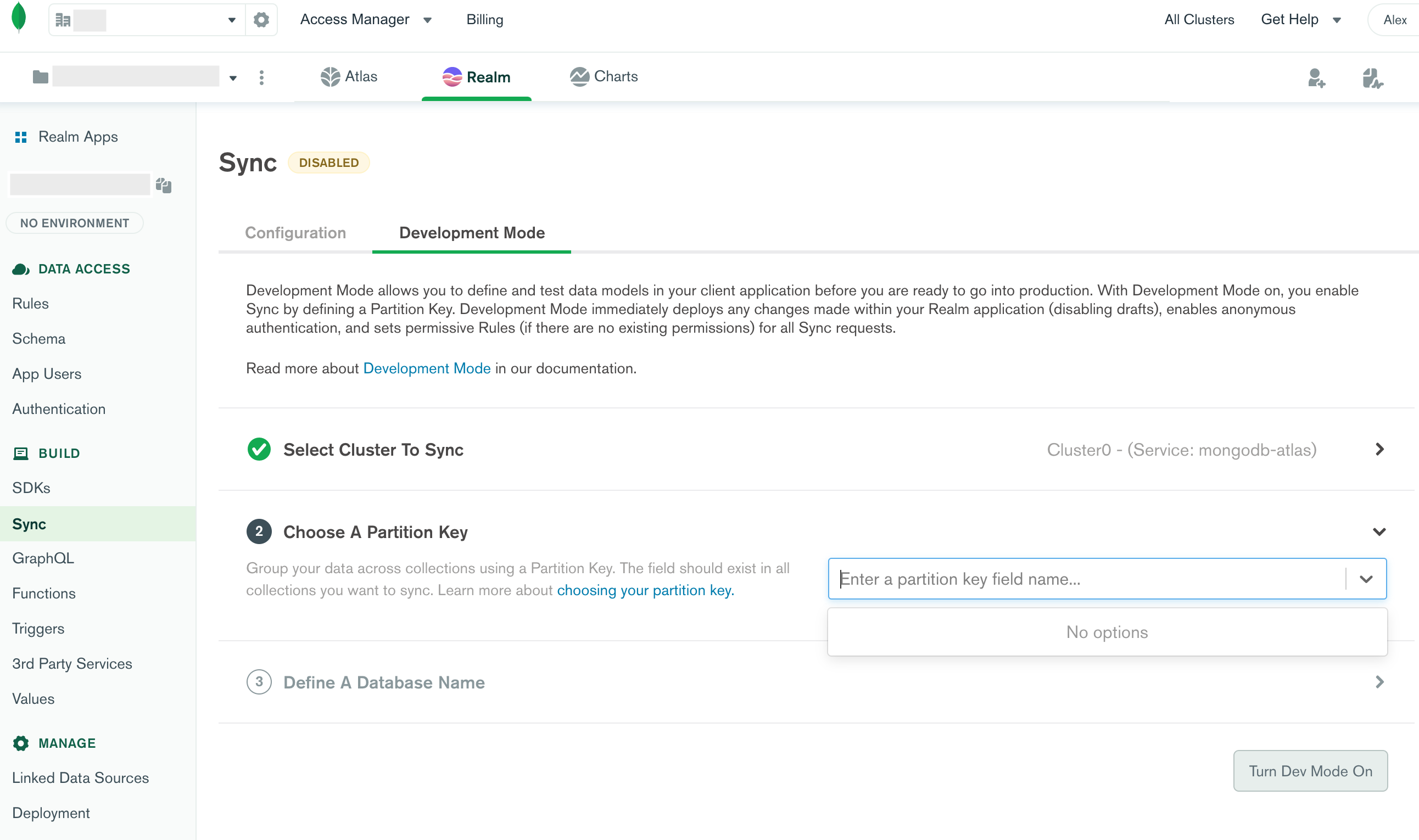

In this step in the web UI, it seems that there are 3 steps:
- Select a Cluster to Sync
- Choose a Partition Key
- Define a Database Name
For Step 1, I can select “Cluster0 - (Service: mongodb-atlas)”
However in Step 2 is where I get stuck: There is a dropdown that says “Enter a partition key field name…”, but when I select the drop down, it says “No options” and I cannot select anytthing. Therefore I can’t go to the third step or turn dev mode on.
The “Get Started with Sync” document doesn’t say anything about pre-populating the realm with data or schema (I thought that’s why I’m choosing Development Mode, so I can define my data on the fly until I figure out what the schema should be).
I’m super stuck here. It’s likely because I don’t understand something. Can someone help me see the light?
