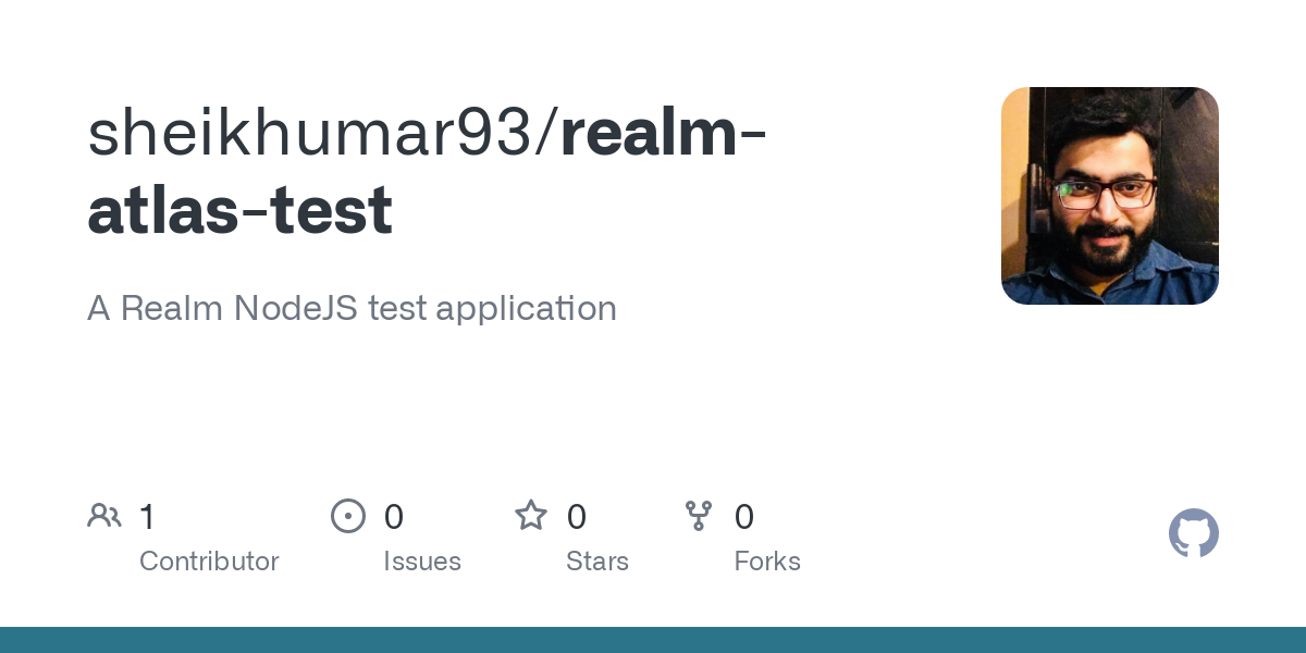

I think we aren’t going to get any further without actually running some sample code. Can you make us a repo on github that produces this issues so we can reproduce it?
Hello Andrew, thanks for all the help. I have created a new project on Github that demonstrate the issues with my approach.
I have been able to run and sync with Mongodb Atlas now with the latest updated code on this repository. Let me check if I can get my existing code to synchronize now.
If it works, feel free to share what the fix was, so that others in the forum can learn from you :slight_smile:
