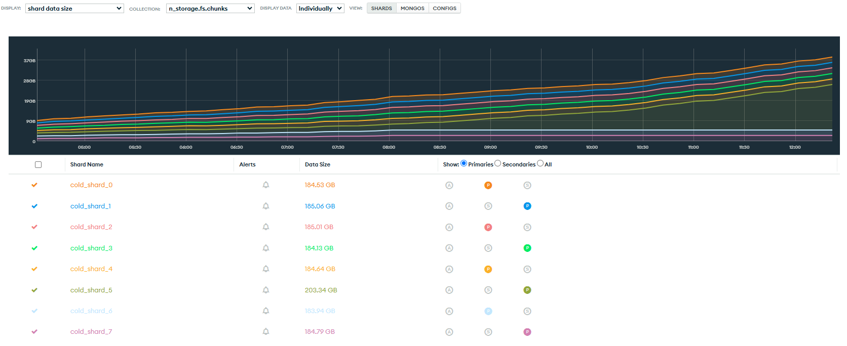

Hello,
I am facing an issue for days now regarding balancing of a gridfs collection.
As ou can see on the capture the storage is not balanced correctly between shards over time :
I recreated my database to reset the sharding because I suspected a problem that disabled the shard but the same problem occurs.
Now I am checking again and I see that nothing is sharded from the shell :
mongos> db.getSiblingDB(“config”).chunks.find({ ns: “n_storage.fs.chunks” }).count()
0
mongos> use config
switched to db config
mongos> db.collections.find({“_id”: “n_storage.fs.chunks”})
{ “_id” : “n_storage.fs.chunks”, “lastmodEpoch” : ObjectId(“67a6a46f6cdb3b52cc4282d4”), “lastmod” : ISODate(“2025-02-08T00:25:19.765Z”), “timestamp” : Timestamp(1738974319, 12), “uuid” : UUID(“b8166ae7-5a88-4024-8893-0ab8c3973218”), “key” : { “files_id” : 1, “n” : 1 }, “unique” : false, “chunksAlreadySplitForDowngrade” : false, “noBalance” : false }
mongos>
I am confused about this issue because data seems splited, but sharding seems not correctly performed,
Thanks for your help

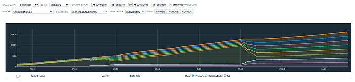

The collection seems that is still going under balancing.
Starting from MongoDB 6.0+ the balancer aim to have a collection equally distributed in term of data size over the shards (read more here )
The shard cold_shard_5
has more data than other shards (~ 145GB more) and orphans document that will get deleted.
If you periodically check the output of $shardedDataDistribution
you should see the number of numOwnedDocuments
for cold_shard_5
decrease with the time until all the shards have approximately the same amount of data.
ABot
(Anon Bot)
February 10, 2025, 8:33am
5
Thanks a lot,
After your message I disabled my backend API that insert in my gridfs and it get balanced faster after that, I guess the migration is working better when the collections is not used.
Now everything is balanced correctly :
