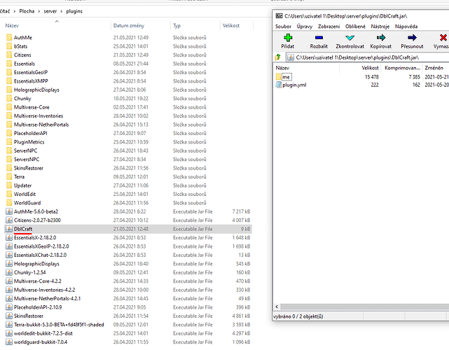

Hi, thanks again for a response.
I’m running this as a plugin, so instead of main() there is onEnable(). Then I’m exporting it into my plugins folder, where it starts together with my server.
Plugins folder and inside the jar:
I think you are true about missing due to compile because I can’t find any MongoDB classes in the exported jar.
Your JAR packager should be configured to be a fat JAR with all the dependencies in it.
Usually I use maven-assembly-plugin for this.
Thank you very much, it works!!!
