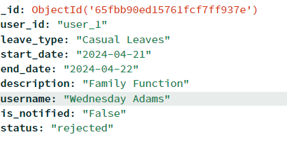

also below is the data that i have in my database

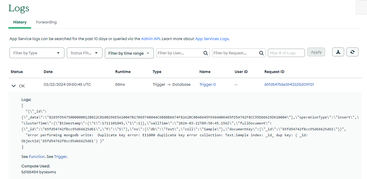

Setting up a test trigger / function with default settings I get the same error when running the trigger in debug mode through the function editor as the variable passed to the function is not a real change object.
Inserting an actual document runs the code as expected, obviously you get some errors if you’re re-inserting the same document as the sample code does.
Adding in a console.log to show what’s going on:
I get this in the log when inserting a document to the collection:
Running through the function editor I get this error, which is expected:
Modifying the code so the insert will insert a copy of the document (by removing the _id field so that we don’t get a duplicate key error):
