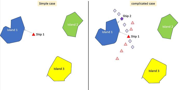

Bullets 1,2: what you are proposing is to reverse the query and try to find which polygons are close to the islands like in this post here
Based on that, I’ll get “island 1” the blue island below in the simple case:
This becomes more complicated as the collection “ships” is spatio-temporal, where it has the coordinates of the ships in different timestamps. The faded colors are instances of the ship in different time and the bold are the ones closest to the island 1.
Also there are many more ships in the collection. But If I get the ones close to island 1, and group by id it is easy to filter out and get K closest ships to that island.
My question is how do you check multiple points from the ships-collection against the islands-collection ?
This would be for 1 point (as per the example in the link), but how to make it for all the ships-collection?
