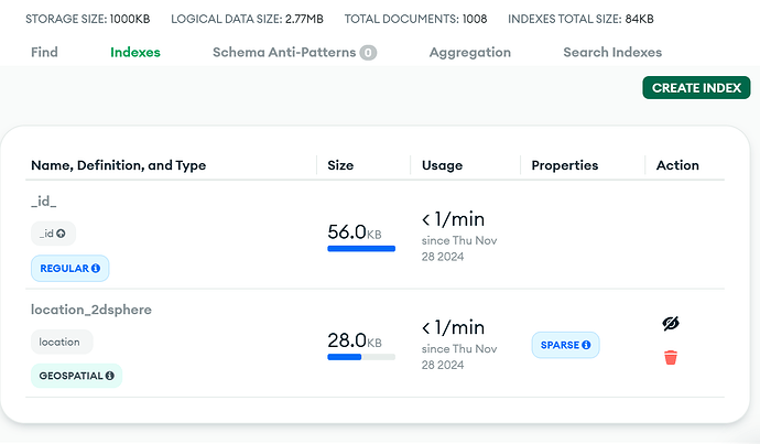

location field:
![Capture|690x179](upload://1uFsgeGJfrga3yppxmekVT4YbBO.png)

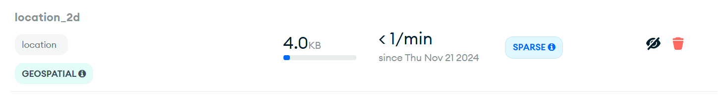

Index field
![Capture|690x129](upload://9M9ciP3d9PwP1gVTKZpd5cYBynB.png)

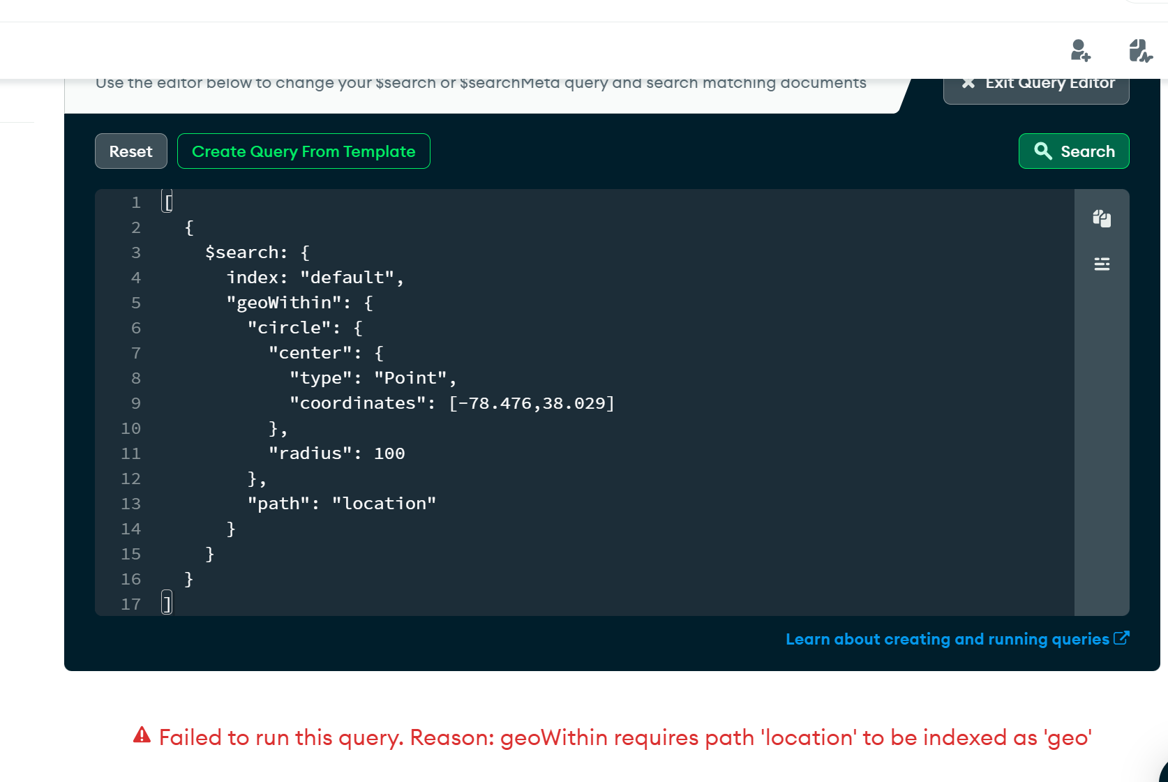

Query error:
![Capture|690x426](upload://7zUViZDyGzTf6QJPU4dva39LGZx.png)

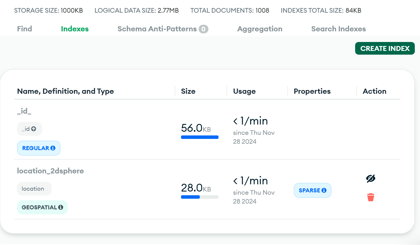

Index field
The same error with geoWithin

Hi Erik, thanks for your help.
I was confused regarding the index because I used the native collection index.
I mean this one.
Thanks to you, the query now works.
