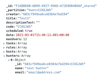

This is what the embedded object looks like in Atlas:
Any pointers or even where to find any info about Realm Functions and Embedded Objects would be awesome. Thanks!

I was able to find the correct embedded object to update by using
const hunterQuery = { "hunters._id": idCode };
the problem is that it pushed a new object into the array rather than finding the correct properties and updating those with the new result.name and result.email.
I only want to update the name and email properties in the existing embedded object in the array. My understanding is that $set will only update the included properties and leave the rest, like your otherStuff property, intact.
I assume that is what this is trying to do, but for me, $push is creating a new Hunter object rather than finding and updating the existing embedded object. I did not set upsert to false, though I assume that not setting it at all would default to false.
