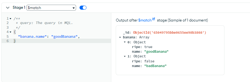

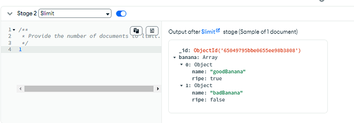

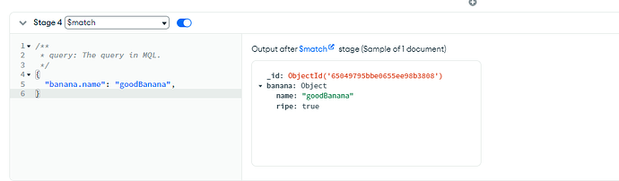

So when you do a findOne, it returns the entire document, to get an element from an array you need to do the $unwind aggregation state. I added the document and did the aggregation with a match and limit to 1. Then it unwinds it into two documents, then matches those two documents for ‘goodBanana’
    $match:
       * query: The query in MQL.
        "banana.name": "goodBanana",

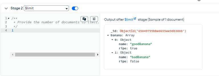

    $limit:
       * Provide the number of documents to limit.
      1,

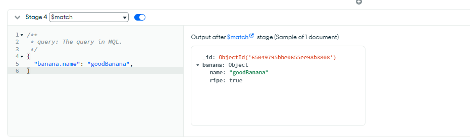

    $match:
Output:
  "_id": {
    "$oid": "65049795bbe0655ee98b3808"
  "banana": {
    "name": "goodBanana",
    "ripe": true

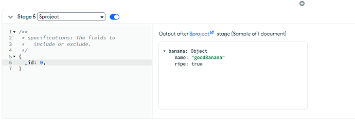

Aggregation stages in Atlas
You can add a $project to remove the _id
