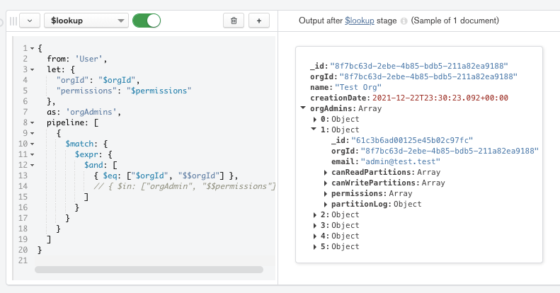

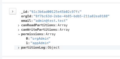

The update to my code is yeiding the same results as my initial query. It seems like the $permissions variable isn’t holding the value I’m expecting. I double-checked the structure of my User model and it’s represented accurately in the TypeScript code above. Here is a screenshot of an example user (there are some additional fields that I didn’t include in my description as they shouldn’t be relevant to the query (the query is being executed in Compass)).
Screen Shot 2021-12-23 at 10.39.58 AM
My updated query looks like this:
  from: 'User',
  let: {
    "orgId": "$orgId",
    "permissions": "$permissions"
  as: 'orgAdmins',
  pipeline: [
      $match: {
        $expr: {
          $and: [
            { $eq: ["$orgId", "$$orgId"] },
            { $in: ["orgAdmin", "$$permissions"] }
It’s a lot cleaner, but is still failing with a warning:
Failed to optimize pipeline :: caused by :: Failed to optimize expression :: caused by :: $in requires an array as a second argument, found: missing
Commenting out the $in aggregation returns data without drama:
Is there a way to print variable values for debugging?
