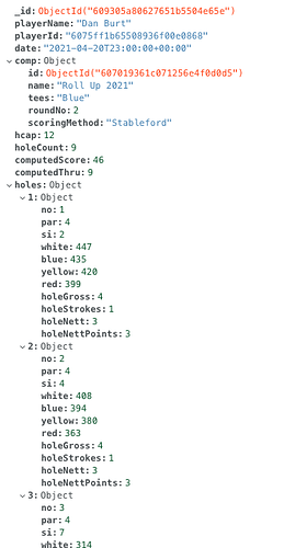

In the Atlas UI, it looks like this:
The holes
array is made up of another array per hole played.
