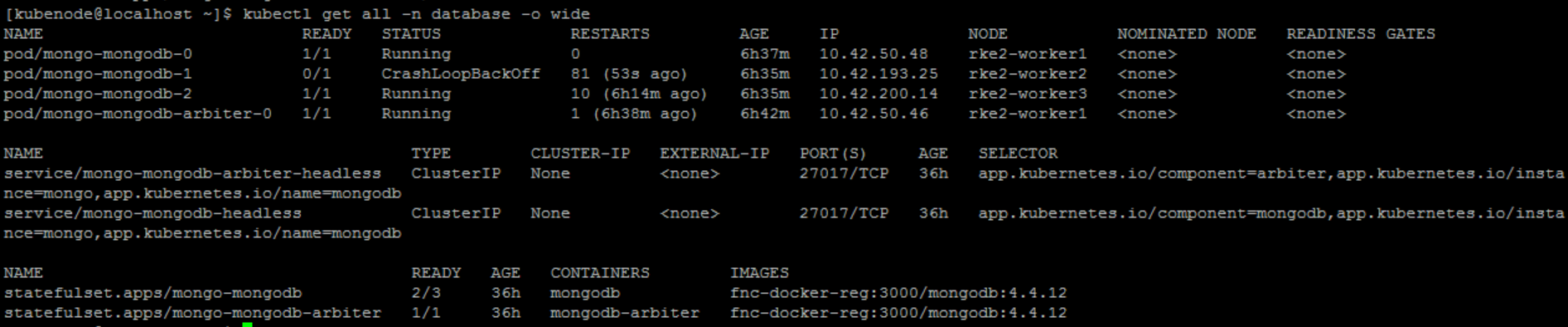

I have deployed mongodb replicaset using helm charts on RKE2 cluster (RHEL8 VMs) using “managed-nfs-storage”. The first mongo replica came up and the PRIMARY is also set properly but the second replica is crashing with the below fsync error.
{“t”:{“$date”:“2023-02-17T18:35:18.407+00:00”},“s”:“E”, “c”:“STORAGE”, “id”:20557, “ctx”:“initandlisten”,“msg”:“DBException in initAndListen, terminating”,“attr”:{“error”:“FileStreamFailed: Unable to write process id 1\n to file (fsync failed): /bitnami/mongodb/data/db/mongod.lock Input/output error”}}
Mongo pods under the database namespace:
Please find below some of the findings around this issue,
