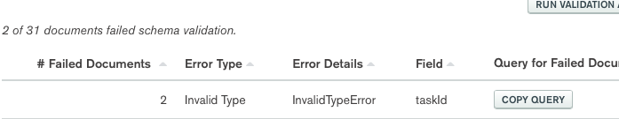

After I insert a new Realm-Object via SDK (Swift or Java) that contains a null value I run into a schema validation error:
2 Invalid Type InvalidTypeError taskId
taskId is a optional attribute defined like:
"taskId": {
      "bsonType": "objectId"
how can i save a null value?
thank you

hi @Andrew_Morgan, yes I defined my primary key and the taskId is not ind the required section. Sorry for the incomplete example!
Also the synchronization works. The only thing is the validation from the object after I inserted it via sdk:
because of the null type here:

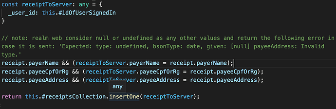

I ran into the same issue today, do you have any update from the team?
I seems that the root cause is that no matter what the field type is, using a function to update it, it must have a value.
Non existent key, key set to null or key set to undefined does not work.
For my optional string schema, I had to pass an empty string ""
I also attempted to update an existing object in the Database that was synced from iOS Client containing an non-existent value for an optional key.
In the Collection that value was Null.
await collection.updateOne(
            { _id: ... },
            { $set: { parentId: newID }},
            { session });
// the object I am updating here contains a key
// { name: null }
it failed stating the the value that was already non existent (NULL in record) needed to be Undefined. But it was Null. (again, the NULL value was set by the sync client form the SDK or Realm server)
Expected: undefined, given: null
it looks like the validation mechanism that runs when updating a value is different that the one during a sync operation in the backend
