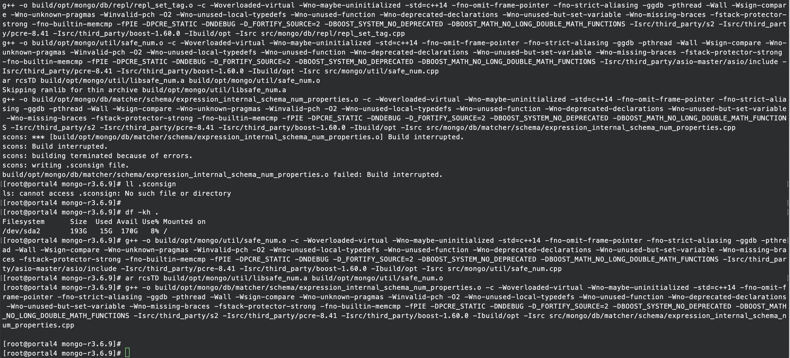

Not sure, no other process was running on machine while compiling the code. The VM was dedicated for compilation purpose only
[root@portal4 mongo-r3.6.9]# free -m
total used free shared buff/cache available
Mem: 11853 624 524 8 10704 11094
Swap: 4095 0 4095
This was the error:

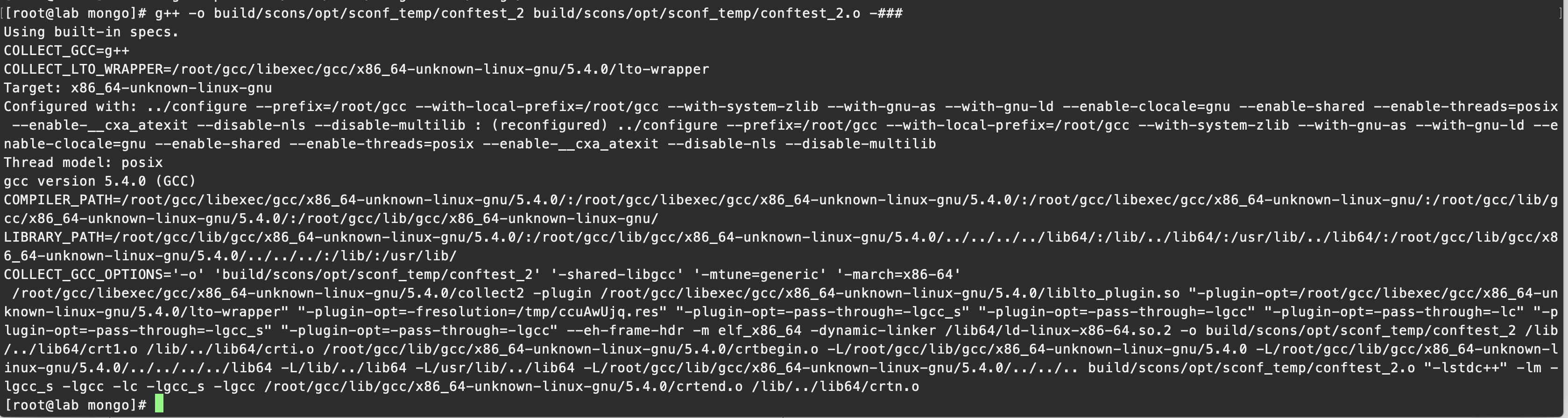

If I don’t add PATH in SConstruct file I get below error:
[root@portal4 mongo-r3.6.9]# python buildscripts/scons.py all
scons: Reading SConscript files ...
scons version: 2.5.0
python version: 2 7 5 'final' 0
Checking whether the C compiler works... yes
Checking whether the C++ compiler works... yes
Checking that the C++ compiler can link a C++ program... yes
Checking if C++ compiler "g++" is GCC... yes
Checking if C compiler "gcc" is GCC... yes
Detected a x86_64 processor
Checking if target OS linux is supported by the toolchain... yes
Checking if C compiler is GCC 5.3.0 or newer...no
Checking if C++ compiler is GCC 5.3.0 or newer...no
ERROR: Refusing to build with compiler that does not meet requirements
See /root/mongoCompilation_TagCode/mongo-r3.6.9/build/scons/config.log for details
Please post the contents of the config.log. Anytime you get this message, you should post the contents of config.log.
