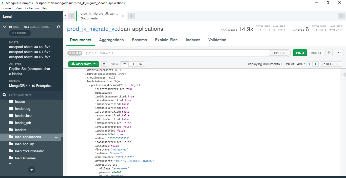

wait i am sending you screen shot so you can understand better

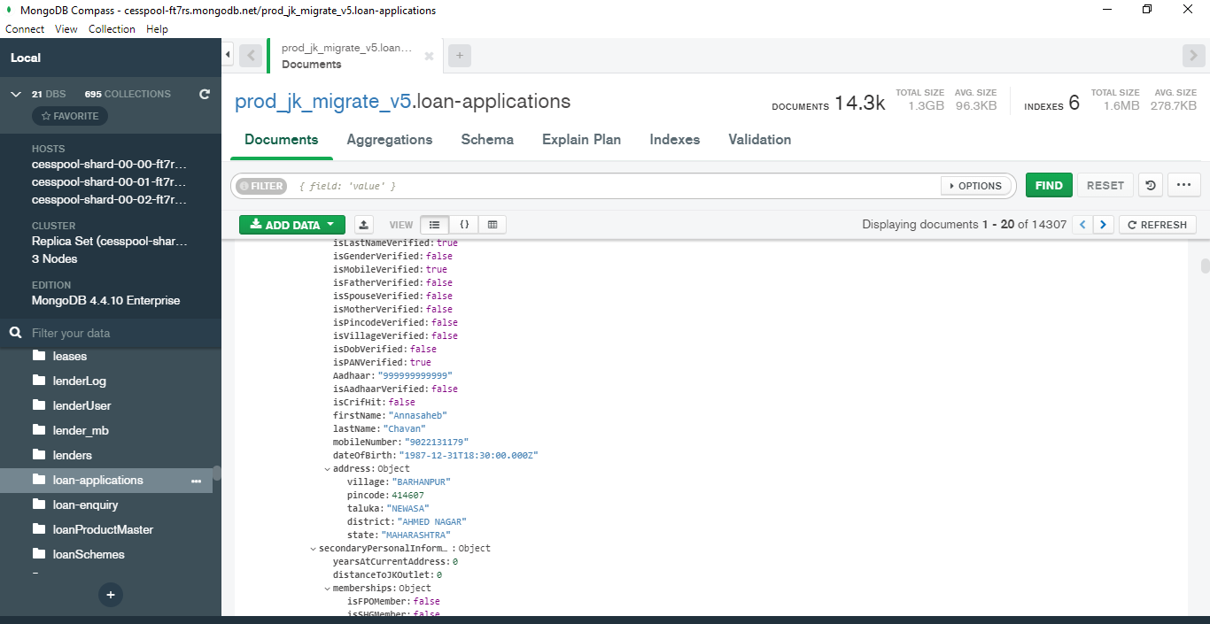

hi @tapiocaPENGUIN as you can see the 3 images there are nested fields
so now how to extract data from these nested field i have tried and converted into CSV but data not extracted the rows are empty
The projection should still work, but you will just need to use a “.” separated format to project the nested fields.
db.coll.find({}, {"_id:0", extras.basicInformation.address: 1", "building: 1", "area":1})

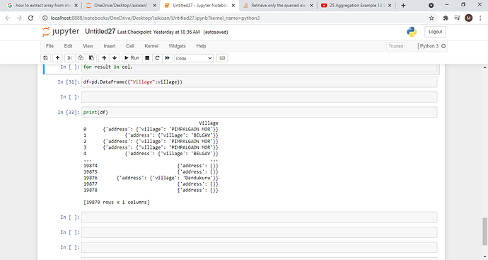

As you can see i get output in dataframe like this
but i dont want the output like this i want only village name
eg: PIMPALGOAN
BELGAV
… etc etc
so please reply how to do this

If you have the data that you need in a dictionary, then you should just be able to find a specific key-value the normal python way. (Although it looks like you are using pandas and I’m no expert in pandas). But I would try something like this:
print(df['address']['village'])
