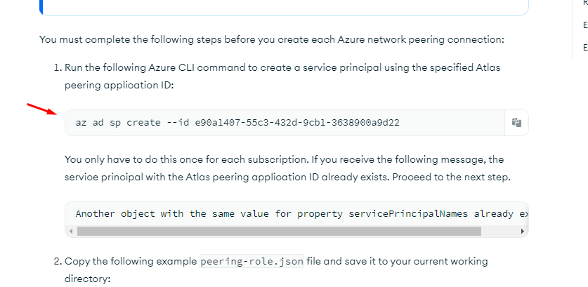

@Davidson_Silva this happened due to an incorrect service principal(enterprise application) on the Azure end. First, create an Azure sp with application ID “e90a1407-55c3-432d-9cb1-3638900a9d22” and used its id in the role assignment’s principal_id
Hi @Thisura_Wijesekera .
I’m sorry, i realy forgotten to response here.
But it is correct. I’ve never thount should you need to use exactly the same application ID!
You don’t need to create a new applicationId. Only use on the existing once principal.
Here the documentation:
