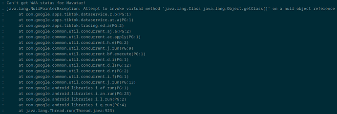

Hi I would like to add my experience to this conversion as I’m in the same boat.
Created a new project using the Expo template code only, ran the command: expo run:android with the Android Studio Emulator open, the development build opens no problem but as soon as I try to add a new entry, the app crashes without error.

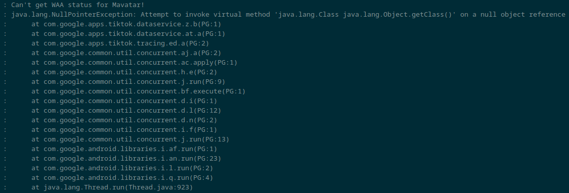

Logcat gives a ton of information but I’m able to get the following error (I can provide a more detailed log if this isn’t helpful):
: Can't get WAA status for Mavatar! : java.lang.NullPointerException: Attempt to invoke virtual method 'java.lang.Class java.lang.Object.getClass()' on a null object reference : at com.google.apps.tiktok.dataservice.z.b(PG:1) : at com.google.apps.tiktok.dataservice.at.a(PG:1) : at com.google.apps.tiktok.tracing.ed.a(PG:2) : at com.google.common.util.concurrent.aj.a(PG:2) : at com.google.common.util.concurrent.ac.apply(PG:1) : at com.google.common.util.concurrent.h.e(PG:2) : at com.google.common.util.concurrent.j.run(PG:9) : at com.google.common.util.concurrent.bf.execute(PG:1) : at com.google.common.util.concurrent.d.i(PG:1) : at com.google.common.util.concurrent.d.l(PG:12) : at com.google.common.util.concurrent.d.n(PG:2) : at com.google.common.util.concurrent.i.f(PG:1) : at com.google.common.util.concurrent.j.run(PG:13) : at com.google.android.libraries.i.af.run(PG:1) : at com.google.android.libraries.i.an.run(PG:23) : at com.google.android.libraries.i.l.run(PG:2) : at com.google.android.libraries.i.q.run(PG:4) : at java.lang.Thread.run(Thread.java:923)
It’s worth mentioning that running a standalone build - eas build - doesn’t have any problem running on the emulator or physical device, only the expo-dev-client seems to have trouble.
Thanks @Ben_Ujdur ,
That’s indeed useful information: it’s interesting to notice that nowhere in the stack trace there’s a sign of the Realm SDK, it’s a TikTok (?) library that crashes instead.
This seems to reinforce the hypothesis that’s not a Realm SDK issue in itself, but more an environment conflict, almost certainly limited to Android (it’s a Google library) and to the expo-dev-client (it works with eas). At this time, we don’t know if it’s just Linux, either, but I’d assume it may be, as we’d likely have many more occurrences reported otherwise.
