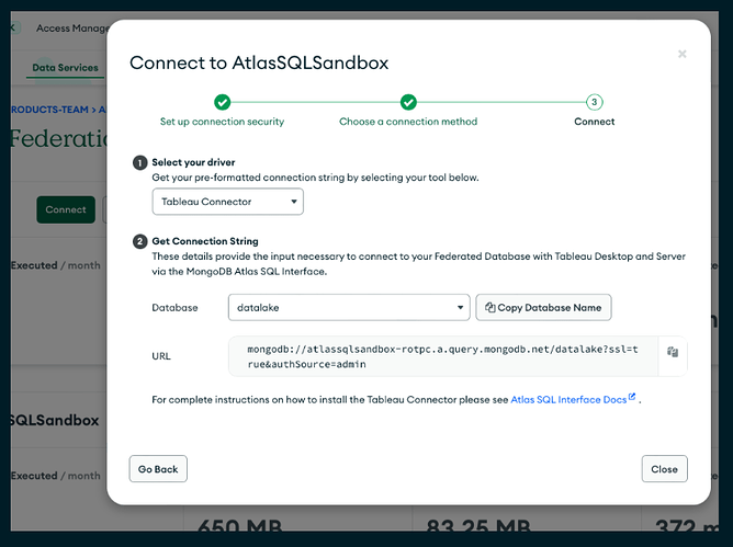

  1. Do you have the proper connection string? notice the format should include “…query.mongodb.net/…”
  2. Do you have database access (user credentials)? and Has you IP address been whitelisted in Atlas?
Hope this info helps…Best, Alexi

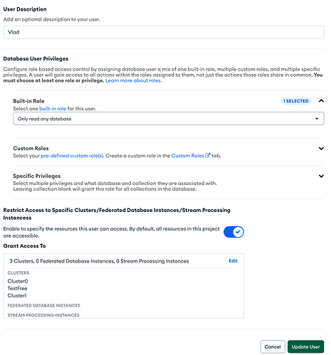

Hello @Marco_N_A1 sorry you are experiencing this. It is a bug with the ODBC driver and we plan to release a fix within a week. To work around this issue right now you can tweak your db user permissions (see below). And I will work with my team to expedite the fixed release.
Here are a few ways to bypass the error you are getting:
Instead of using a “Quickstart” federated DB, create an “Advanced” configurable Federated DB Instance (FDI). This will allow you to restrict access to this FDI in the database permissions.
If you’d like to email me to provide me your exact permissions and SQL Interface configuration, I would be more than happy to get you beyond this error.
Best,
Alexi
alexi.antonino@mongodb.com
Or instead of creating the Advanced config of the Federated DB instance, you may use the Quickstart, but you must remove the “Database User Privileges” and set the built in role to read any database. I am also testing to see if it is plausible to use a Quickstart, restrict permissions based on the underlying cluster and permit using the read any db role. I will report back to this thread today to let you know what I find, and to hopefully let you know when to expect the new ODBC driver.
