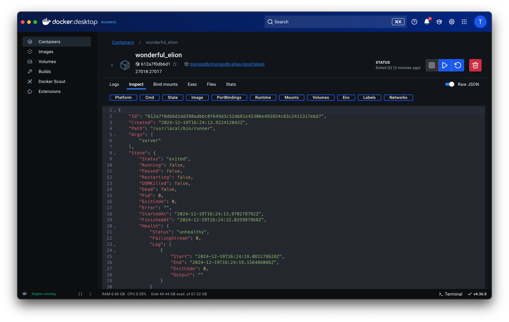

@Patrick_Vermeij when you start the container with
docker run -p 27018:27017 mongodb/mongodb-atlas-local:latest
do you mind doing a docker inspect <containerId> and share the output here together with the container logs (docker logs <containerId>)?
You can also get inspect and logs from docker desktop:
Thanks. Below is the output. I changed the redhat URLs into --url-- placeholders as I cannot put more than 2 links in my post (new user).
Also have the output of docker run, too big to paste and cannot upload it (new user):
