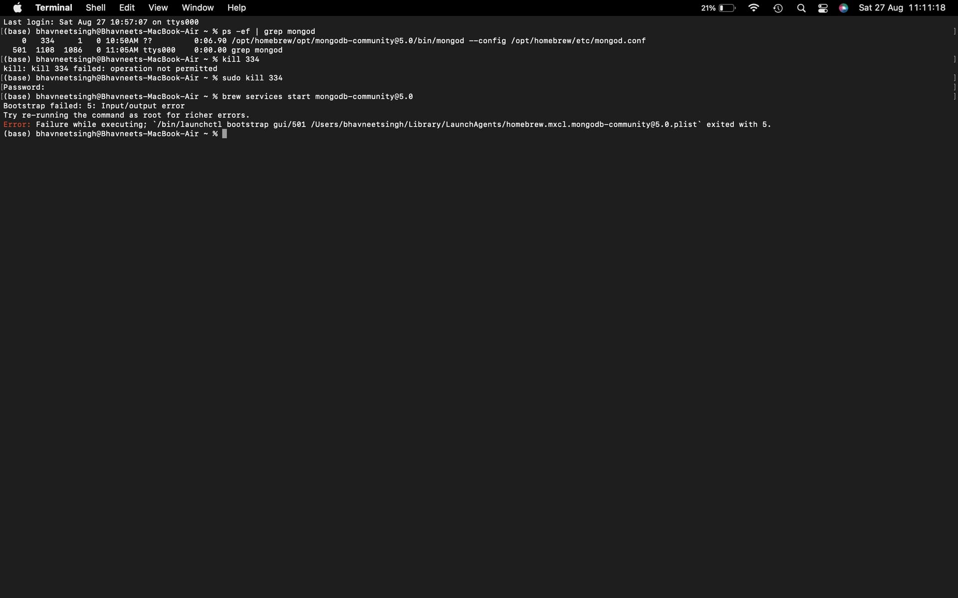

@Doug_Duncan sir I did same as you said and getting this

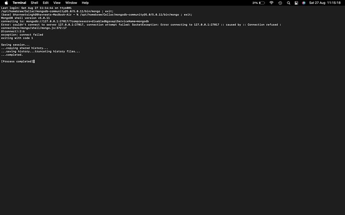

and now with mongo I am getting this error
