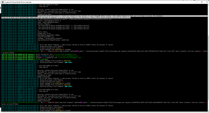

Hello. I have a problem that even though I choose the 0.0.0.0/0 IP
My heroku app didn’t work and it keeps on crashing
Please see the logs. And can someone help me. Thank you.

If your cluster has 0.0.0.0/0 in the IP access list, it’s something else. Is the port 27017 open? Are you sure that you have the right credentials? Is your driver compatible with your current cluster version?
I see some suspicious line in their like the line “failed to bind to $PORT”. Looks like the port is evaluated to $PORT instead of the an actual port value. Also later it says “MONGO CONNECTED”. So is it connected or not? Maybe it’s a code issue so if you can share the relevant piece of code, maybe this could help.
But before we go further in the investigation, I would eliminate that possibility by testing a Hello World project that works for sure.
