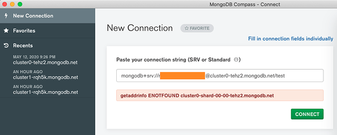

I am trying to connect to my Database Cluster, but I get the following error:
"getaddrinfo ENOTFOUND cluster0-shard-00-00-tehz2.mongodb.net"
Please see screenshot below. Any ideas how to fix this?

Are you able to ping your cluster?
May be the hostname is not correct
Please check again
Alternately you can try fill in connection fields individually tab

The cluster cluster0-tehz2 does not seem to be setup correctly.
: steevej @ asus-laptop ; dig any _mongodb._tcp.cluster0-tehz2.mongodb.net ; <> DiG 9.16.1 <> any _mongodb._tcp.cluster0-tehz2.mongodb.net ;; global options: +cmd ;; Got answer: ;; ->>HEADER<<- opcode: QUERY, status: NXDOMAIN, id: 45103 ;; flags: qr rd ra; QUERY: 1, ANSWER: 0, AUTHORITY: 1, ADDITIONAL: 1 ;; OPT PSEUDOSECTION: ; EDNS: version: 0, flags:; udp: 512 ;; QUESTION SECTION: ;_mongodb._tcp.cluster0-tehz2.mongodb.net. IN ANY ;; AUTHORITY SECTION: mongodb.net. 899 IN SOA ns-761.awsdns-31.net. awsdns-hostmaster.amazon.com. 1 7200 900 1209600 60
We usually get the info about the replica set nodes forming the cluster as in:
: steevej @ asus-laptop ; dig any _mongodb._tcp.cluster0-xahr1.mongodb.net ; <> DiG 9.16.1 <> any _mongodb._tcp.cluster0-xahr1.mongodb.net ;; global options: +cmd ;; Got answer: ;; ->>HEADER<<- opcode: QUERY, status: NOERROR, id: 52529 ;; flags: qr rd ra; QUERY: 1, ANSWER: 3, AUTHORITY: 0, ADDITIONAL: 1 ;; OPT PSEUDOSECTION: ; EDNS: version: 0, flags:; udp: 512 ;; QUESTION SECTION: ;_mongodb._tcp.cluster0-xahr1.mongodb.net. IN ANY ;; ANSWER SECTION: _mongodb._tcp.cluster0-xahr1.mongodb.net. 59 IN SRV 0 0 27017 cluster0-shard-00-00-xahr1.mongodb.net. _mongodb._tcp.cluster0-xahr1.mongodb.net. 59 IN SRV 0 0 27017 cluster0-shard-00-01-xahr1.mongodb.net. _mongodb._tcp.cluster0-xahr1.mongodb.net. 59 IN SRV 0 0 27017 cluster0-shard-00-02-xahr1.mongodb.net.
