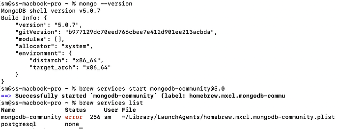

I followed these steps to install MongoDB:
When I start running MongoDB, no error pops up. It just says " ==> Successfully started mongodb-community (label: homebrew.mxcl.mongodb-commu"
But when I check the status, I get a 19968 error:
Also, when I check mongo --version, I get this error: “zsh: bad CPU type in executable: mongo”

I installed Rosetta. When checking mongo --version now, it looks correct. But when I check the status after running Mongo, it still shows an error:
What should I do now? Thank you.

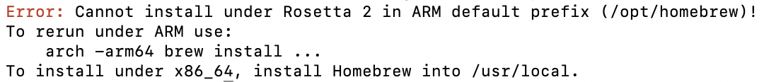

I also tried reinstalling mongoDB in a rosetta clone terminal, but this error pops up:

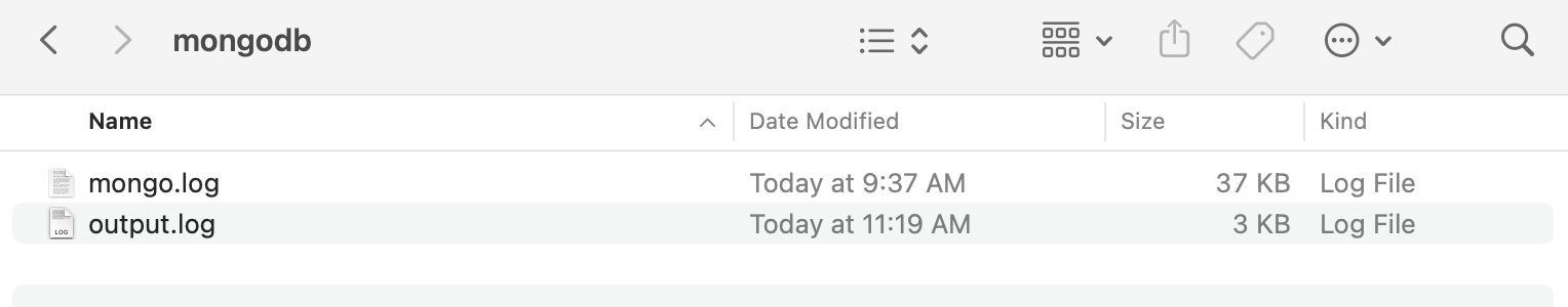

I see two logs in my /var/log/mongodb folder:
  1. mongo.log - When I open, it says unable to read the file.
  2. output.log:

I do not have a mongod.log. These are the logs I see:
I meant mongo.log only.On other os it is named as mongod.log
So why you are not able to open/read this file?
Can you show file permissions from terminal prompt instead of explorer view
ls -lrt mongod.log
