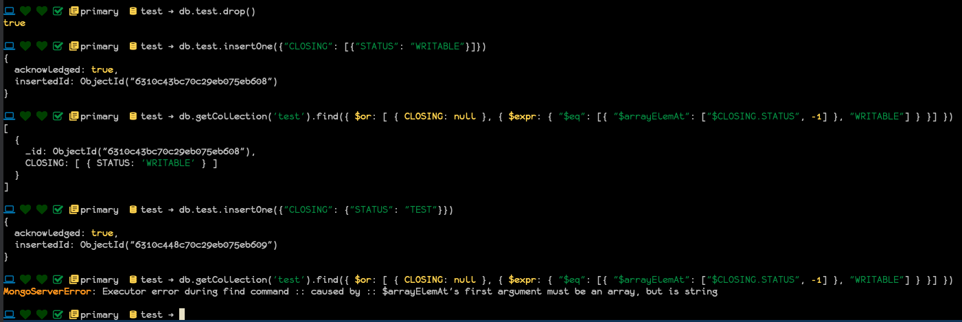

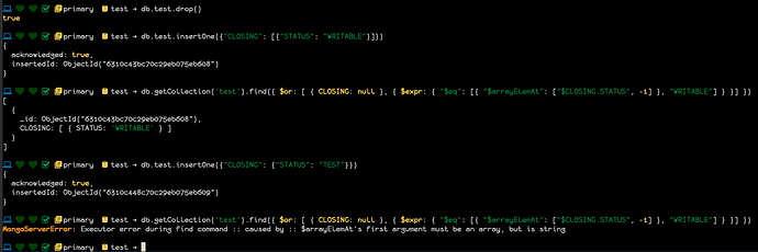

Is it possible that sometimes CLOSING is a subdocument with a STATUS field? I can get the error mentioned if I run db.test.insertOne( { "CLOSING": { "STATUS": "WRITABLE" } } )
I changed my attribute “CLOSING” by “CLOSED” and the queries work because i have another records with CLOSING attribute (object type) but i don’t understand why my querie work without $or. Can you explain me ?
Thanks for your answer.
Queries are not executed directly, but the query planner first makes optimizations on them.
I think your first query is optimized so that the documents without an array in “CLOSING.STATUS” are filtered. but when you use “CLOSING:null” it gives up that optimization and uses all documents whether STATUS is an array or not, causing this error.
