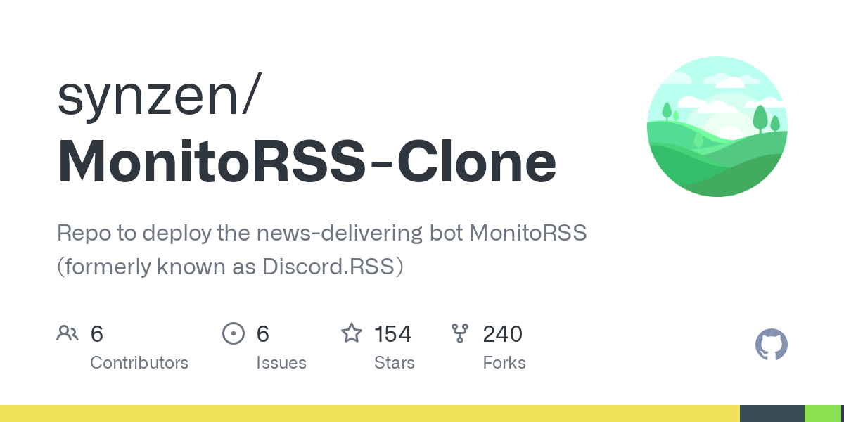

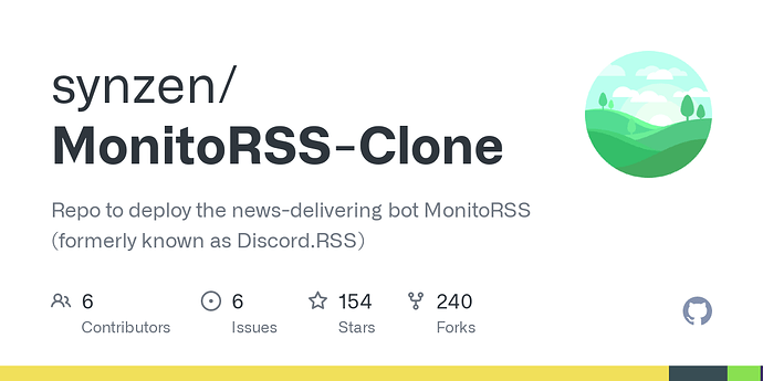

Fork the [MonitoRSS-Clone repo](https://github.com/synzen/MonitoRSS-Clone) by clicking the Fork button at the top right of the page.
Go to your bot application on https://dashboard.heroku.com/apps.
Then go to the Deploy tab, select GitHub and connect your account. Search for the repo by typing MonitoRSS then pressing Search. Connect the repo named `yourusername/MonitoRSS-Clone`.
Once you've connected your fork, scroll down to manual deploy and deploy the master branch. Once the entire deploy operation has completed, refresh the page.
