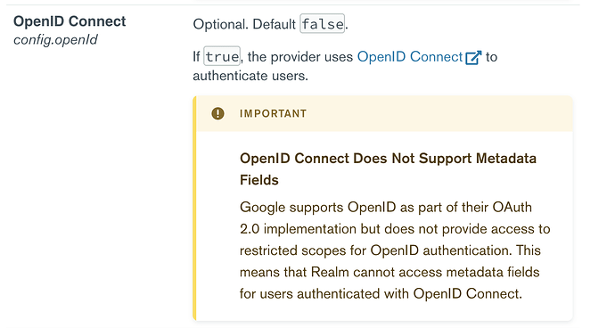

I wasn’t able to figure out whether you were using OpenID connect or not. If you are using OpenID, then metadata isn’t something Realm provides

I’ve also experienced the same issue. I cannot use Google provider unless I check that “OpenID Connect” option in the Authentication Providers tab. That way I’m not able to get user information like the email address, profile photo etc. I can just see the full name and nothing else.
