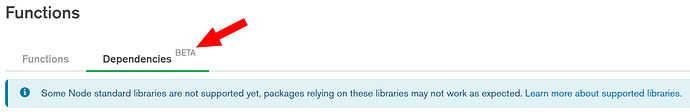

I also assumed it was a dependency issue.
You can read more about it here:
https://docs.mongodb.com/realm/functions/upload-external-dependencies/
This is still a beta feature for this reason. It’s clearly not finished and not working as it should at the moment for many libs… I also suffer for the same problem on a few of my projects :confused:. Hopefully this will be resolved soon!
Let me know if your rep or support contact has a better alternative but I have big doubts for now…

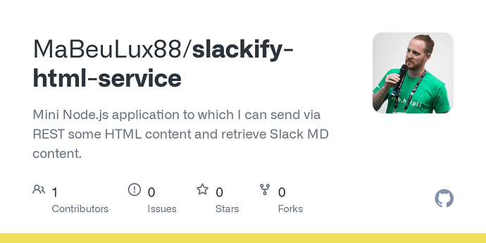

In one of my project I needed slackify-markdown so the only “smart” way I found to get away with this was this:
I created a little REST service that I hosted in a corner of an S3 server that I have that answers to my Realm post queries and answers the result I wanted to execute in my Realm function in the first place…
Silly but… Once the dependencies are fixed and not beta anymore, it will be easy to fix my project and replace the call by the actually module function.
Cheers,
Maxime.
