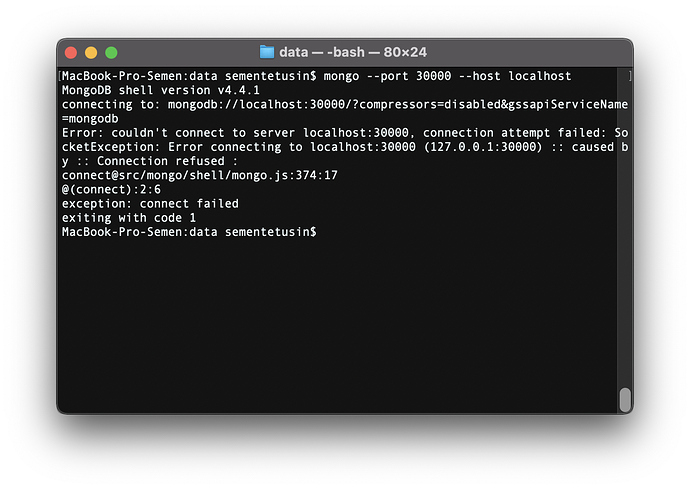

Error connecting to localhost:30000
I am trying to connect mongo using port and localhost, but I always have this problem (error).
I did a search for everything I could find on the internet, but nothing helps. What could be the mistake? Perhaps I am not correctly identifying the host?
MongoDB shell version v4.4.1
I installed Mongo using brew
I have macOS Big Sur 11.0.1

What should I check? I entered this command and was given this
Снимок экрана 2020-11-21 в 16.17.29
