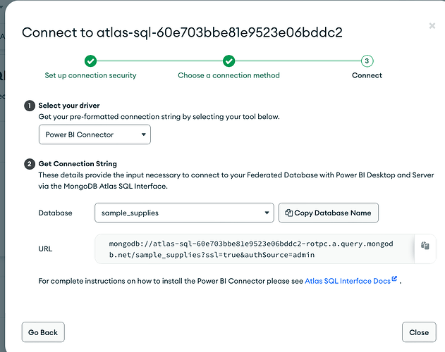

Hi There - I can tell right away that you are not using the correct MongoDB URI. Atlas SQL requires a Federated Database Instance, and then the SQL Endpoint/URI points to that. You can enable Atlas SQL with a Quickstart federated database or Advanced configuration - see here https://www.mongodb.com/docs/atlas/data-federation/query/sql/getting-started/

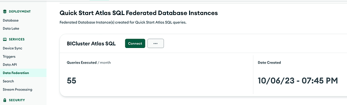

And once you have enabled Atlas SQL, you then select the “connect” button from the federated database instance cards then select the Atlas SQL tile:
Hope this helps.

I saw in the image that the driver is selected for PowerBI. Can you tell me if I can make it work this same way in the Alteryx program?
