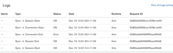

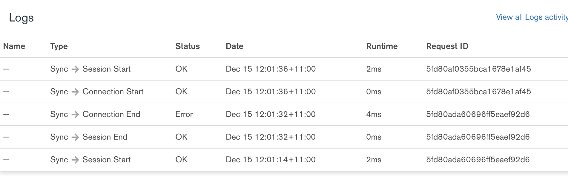

@Christian_Huck - I am currently trying to migrate data from Realm Cloud and seem to have the same issue when creating objects in the new MongoDG Realm from the client. All the data gets created in the client realm file and is accessible from the client SDK but no data shows up in Atlas.
Where exactly are the client logs located and where are the sync logs to be found on the server ? I assume you are using an Atlas cloud instance as well. If I use a web browser and look at the logs in the Realm Apps logs screen I just see the following:
Is there some other location one can look for sync errors ?
Error:
could not decode next message: error reading body failed to read: read limited at 16777217 bytes
Logs:
[ “Connection was active for: 15s” ]
SDK:
darwin vRealmJS/10.1.1
Platform Version:
v12.20.0
Ah - there is an error - what does this mean ?
